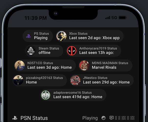

Nope tbh haven’t bothered since, I think I just didn’t find the right selector yet and thats the issue.
found a way (the way?) to fix the 2025.3 changes for the new hui-view-header, and it seems as simple as adding that :wink:
The generic badge setting works fine now, so mo need to set that icon on each and every badge individually.
only issue I still face is the fact that the scrollable badges go beyond the actual device screen, and dont stay within the view.
Ive added a hard coded max-width: 390px; because that is my devices width (iPhone 13 pro), but it isnt ideal.
Especially not since the scroller kicks in before that on my desktop, which is set wider.
needs some more work, but its a promising beginning.

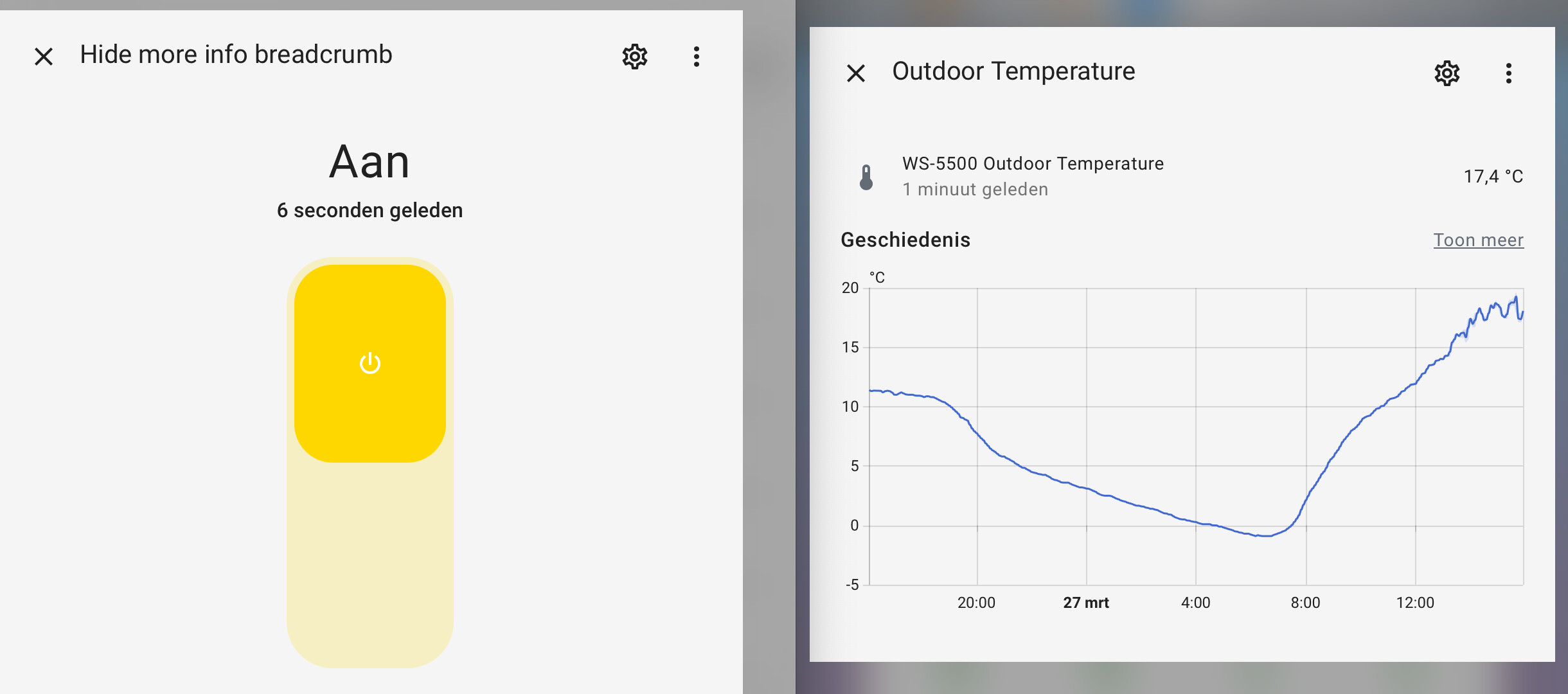

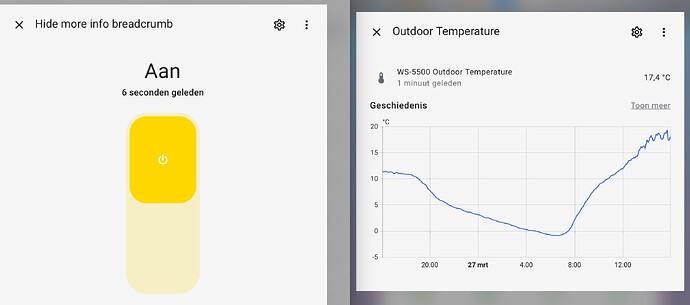

Home Assistant 2025.4 adds a new breadcrumb above the entity name in the more-info, showing the area and the device the entity belongs to.
SInce I feel that should not be there always (it clutters the view of that card, ands not meant for everyone imho), Ive added a theme mod so we can conditionally set it, like eg for administrators, or in dev mode…
I had to add it to the -yaml section because of the other mods I have there,
  card-mod-more-info-yaml: |
    ha-dialog-header: |
      .breadcrumb {
        {% if is_state('input_boolean.hide_more_info_breadcrumb','on') %}
        display: none
        {% endif %};
      .mdc-dialog {
        backdrop-filter: blur(17px) !important;
        -webkit-backdrop-filter: blur(17px) !important;

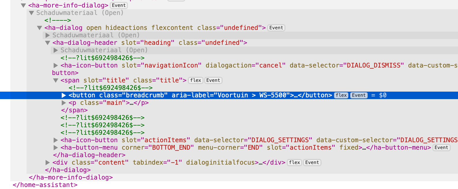

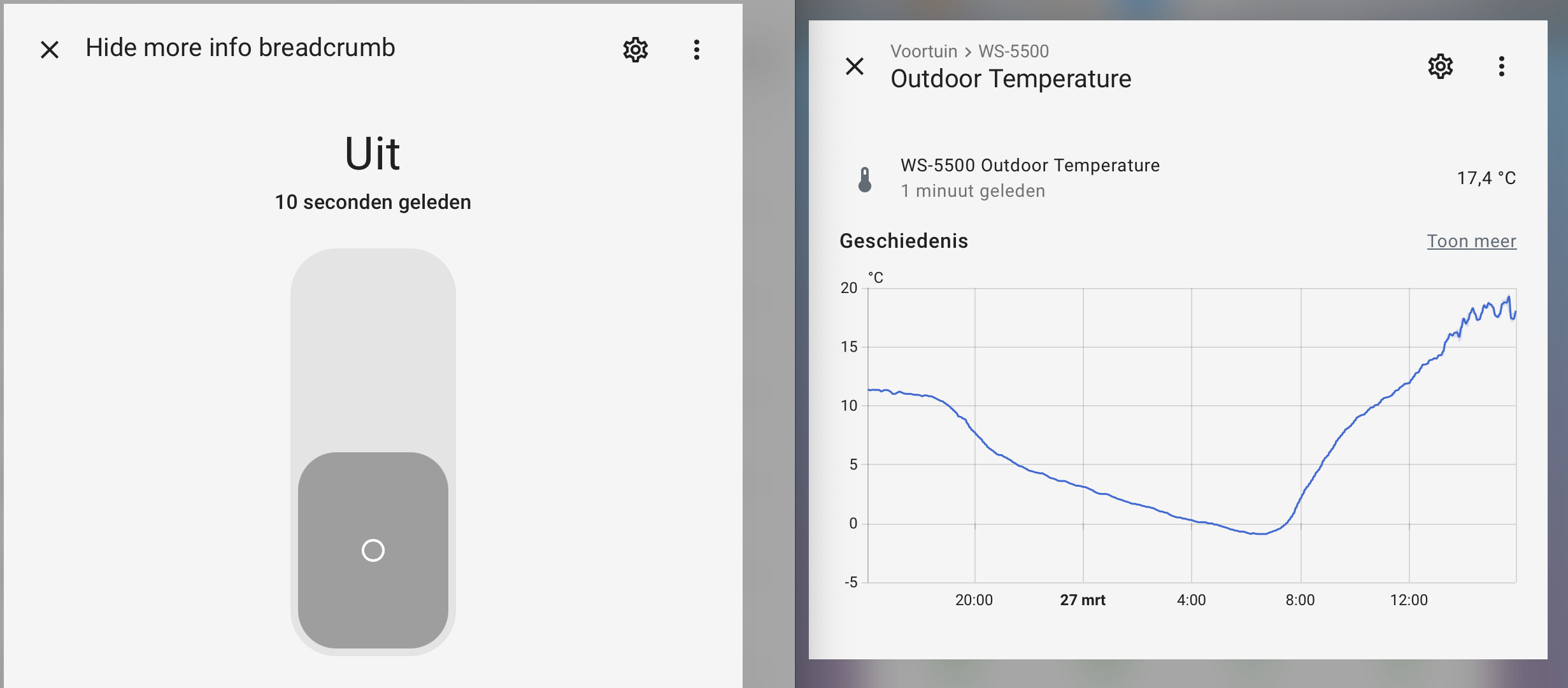

result:
UPDATE
hold your horses… in a next beta, they changed the path to the breadcrumb to be in the button, which breaks my mod above…
but, it turns out to be a matter of adding !important…
    ha-dialog-header: |
      .breadcrumb {
        display: none !important
        {% endif %};
Not worked in 2025.3.4, please tell me how to fix it? Thanks in advance.
Check with Code Inspector, one more layer seems to be added recently.

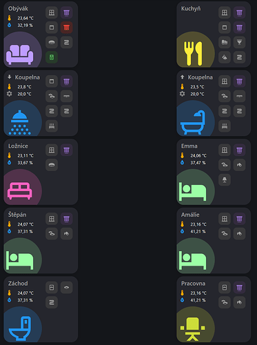

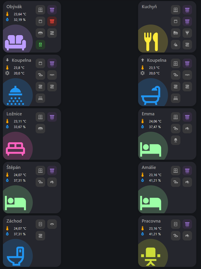

Hi, I’m asking for advice on styling cards via card_mod. I designed a room card, or rather modified and adjusted it from the designs here in the community, but the card displays a lot of data. It contains many entities that are still conditioned in various ways, but I got into a situation where I have a lot of evaluations in the card across entities and another problem is that in one display in the dashboard I have, for example, 10 of these cards, the problem then arises in the actual rendering of the cards, it is terribly demanding on performance and rendering due to the concurrency and unoptimized code, precisely the repeating styles for both the card itself and for individual chips. I moved the conditions to the templates so that they are not evaluated directly in the shortener when the page is rendered, so that the logic runs on the server and not the frontend as such, but the problem is most likely in the repeating style code, e.g. the code for one card has 293 lines, see the code.
Is there any way to unify those repeating styles in such code into a theme and load/preload them globally and not have repeating style text multiple times in one tab? I tried to come up with something using chatGPT, claude, but nothing that would work 100%, it always turned out even worse.
Thanks in advance for answering my complicated question
I am attaching a screenshot of several tabs in one view and the yaml code of one tab itself

      - type: template
        entity: cover.obyvak
        icon: "{{ states('sensor.zaluzie_obyvak_ikona') }}"
        icon_color: "{{ states('sensor.zaluzie_obyvak_barva') }}"
        tap_action:
          action: more-info
        content: ""
        card_mod:
          style: |
            ha-card {
              padding: 5 !important;
              --chip-icon-size: 22px;
              --chip-background: {{ states('sensor.zaluzie_obyvak_barva_pozadi') }};
             display: flex;
              align-items: center;
              justify-content: flex-start;
              text-align: left;
              font-size: 35px !important;
              font-weight: normal !important;
              height: 36px !important;
              width: 36px !important;
              border: 0 !important;
              box-shadow: none !important;
              border-radius: 10px !important;
              position: relative;
            ha-card::after {
              {%- set pos = state_attr('cover.obyvak', 'current_position') | int -%}
              {%- if pos > 0 and pos < 100 -%}
                content: "{{ pos }}%";
                position: absolute;
                top: -13px;
                right: -13px;
                width: 20px;
                height: 1px;
                text-align: center;
                background: #5e5656;
                color: #DADADA;
                border-radius: 50%;
                font-size: 10px;
                padding: 11px 2px;
                line-height: 0;
              {%- else -%}
                display: none;
              {%- endif -%}
            ha-card > * {
              padding-left: 7px !important;
      - type: template
        entity: binary_sensor.okno_bok_obyvak_okno
        icon: |
          {{ states('sensor.okno_bok_obyvak_okno_ikona') }}
        tap_action:
          action: more-info
        card_mod:
          style: |
            ha-card {
              flex: 0 0 48% !important;
              --chip-background: {{ states('sensor.okno_bok_obyvak_okno_barva_pozadi') }};
              --color: {{ states('sensor.okno_bok_obyvak_okno_barva') }};
              justify-content: center;
      - type: template
        entity: cover.obyvak_bok
        icon: "{{ states('sensor.zaluzie_obyvak_bok_ikona') }}"
        icon_color: "{{ states('sensor.zaluzie_obyvak_bok_barva') }}"
        tap_action:
          action: more-info
        content: ""
        card_mod:
          style: |
            ha-card {
              --chip-background: {{ states('sensor.zaluzie_obyvak_bok_barva_pozadi') }};
             display: flex;
              text-align: left;
              position: relative;
            ha-card::after {
              {%- set pos = state_attr('cover.obyvak_bok', 'current_position') | int -%}
                position: absolute;
                top: -13px;
                right: -13px;
                width: 20px;
                height: 1px;
                text-align: center;
                color: #DADADA;
                border-radius: 50%;
                font-size: 10px;
                padding: 11px 2px;
                line-height: 0;
              {%- else -%}
                display: none;
              {%- endif -%}
            ha-card > * {
      - type: template
        entity: switch.obyvak
        icon: hue:friends-of-hue-iq-flush
        tap_action:
          action: toggle
        card_mod:
          style: |
            ha-card {
              --chip-background: {{ states('sensor.switch_obyvak_barva_pozadi') }};
              --color: {{ states('sensor.switch_obyvak_barva') }};
      - type: template
        entity: light.obyvak_tv_stolek
        icon: hue:lightstrip
        tap_action:
          action: toggle
        card_mod:
          style: |
            ha-card {
              --chip-background: {{ states('sensor.light_obyvak_tv_stolek_barva_pozadi') }};
              --color: {{ states('sensor.light_obyvak_tv_stolek_barva') }};
      - type: template
        entity: media_player.yamaha_receiver
        icon: mdi:speaker
        card_mod:
          style: |
            ha-card {
              --chip-background: {{ states('sensor.media_player_yamaha_receiver_barva_pozadi') }};
              --color: {{ states('sensor.media_player_yamaha_receiver_barva') }};
    card_mod:
      style: |
        .chip-container {
          display: flex !important;
          flex-flow: row wrap !important;
          gap: 8px;
          margin: 8px;
          margin-left: 10px;
          margin-top: 15px;
          .container {
            align: end;
card_mod:
  style: |
    ha-card {
      max-width: 220px;
      min-width: 220px;
      max-height: 195px;
      min-height: 195px;
