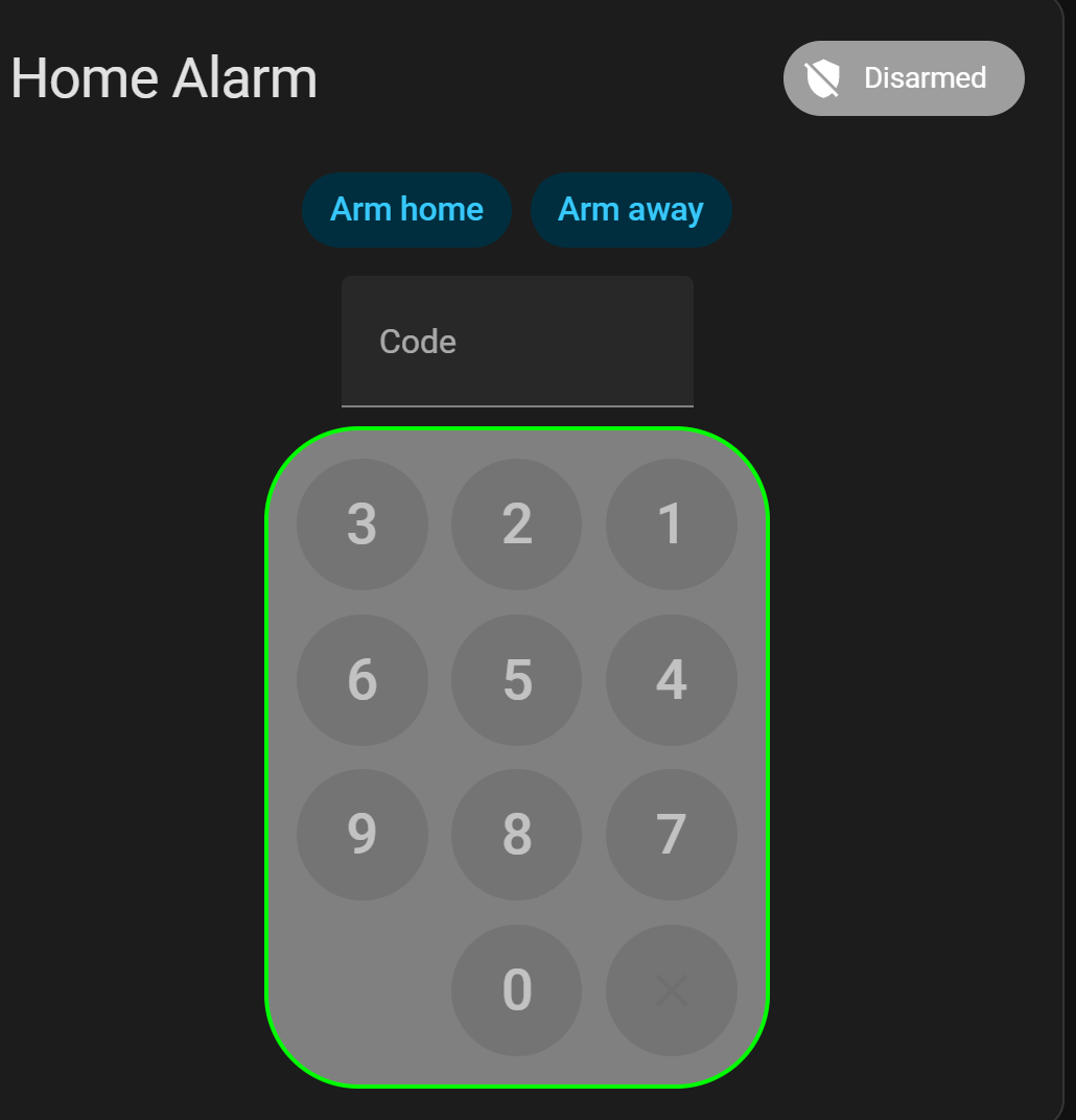

I want to add to the theme card-mod to modify the alarm-panel.
All I want is to add a CSS value of direction: ltr to the #keypad.
My language is right-to-left, and this creates a “mirror” effect on the keypad.
The reason I want to add this globally and not per card is because the keypad opens in a ha-dialog, and I don’t have a way to modify it individually…
I’ve been struggling with this for a few days and can’t figure it out.
I’d really appreciate any help, friends. Thanks in advance! :slight_smile:
Does this work outside a theme?
In addition, please post a subset of your theme to include the initial code ad the alarm card mod code.
type: alarm-panel
states:
  - arm_home
  - arm_away
entity: alarm_control_panel.your_alarm
card_mod:
 style: |
  .keypad {
    gap: 40px !important;
    background: #333333;
    border: 2px solid lime;
    border-radius: 40px;
    direction: ltr;
An example reversing the keypad numbers

I am not sure that RTL keypads should have a mirrored look like shown here.
Out of curiosity, changed in my iPhone a language to Hebrew, a keypad in Calculator did not change. Of course, this cannot be considered as a proof that keypads should not be mirrored.
Anyway, there was a fix from a person who contributes a lot for RTL-users and in one of his PR a direction was fixed as “LTR” (although later this line was removed…), probably he knows what is a correct look?
