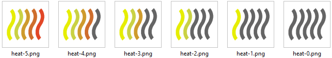

So my baseboard thermostats icons in my picture-elements card are showing the power intensity like these:
This is what custom-ui has for my thermostats
