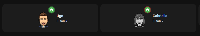

I’m creating two person cards with Mushroom. I managed to change the person’s colors when they’re away from home and the flashing red ring around the badge, but I can’t get the badge to change from green to red or the text from “at home” to “away.” Can you help me, please?
PS: I created a binary_sensor.gabriella_presenza_reale. which includes the Wi-Fi, GPS, and person.gabriella trackers. It seems to work, but I don’t understand why the card isn’t updating.

and this is the code in the header of the two card persons:

secondary_info: state
add this for state
and you must ensure that the entity person. has the actual state ‘home’ or ‘not_home’ … because the badge changes according to the entity state, not the binary_sensor that you have set.
yes ok thanks John the change of badge status works, but also changing the person tracker from gps to wifi I lost tracking on the map, you can’t have everything
U can, create a device tracker instead of a binary
