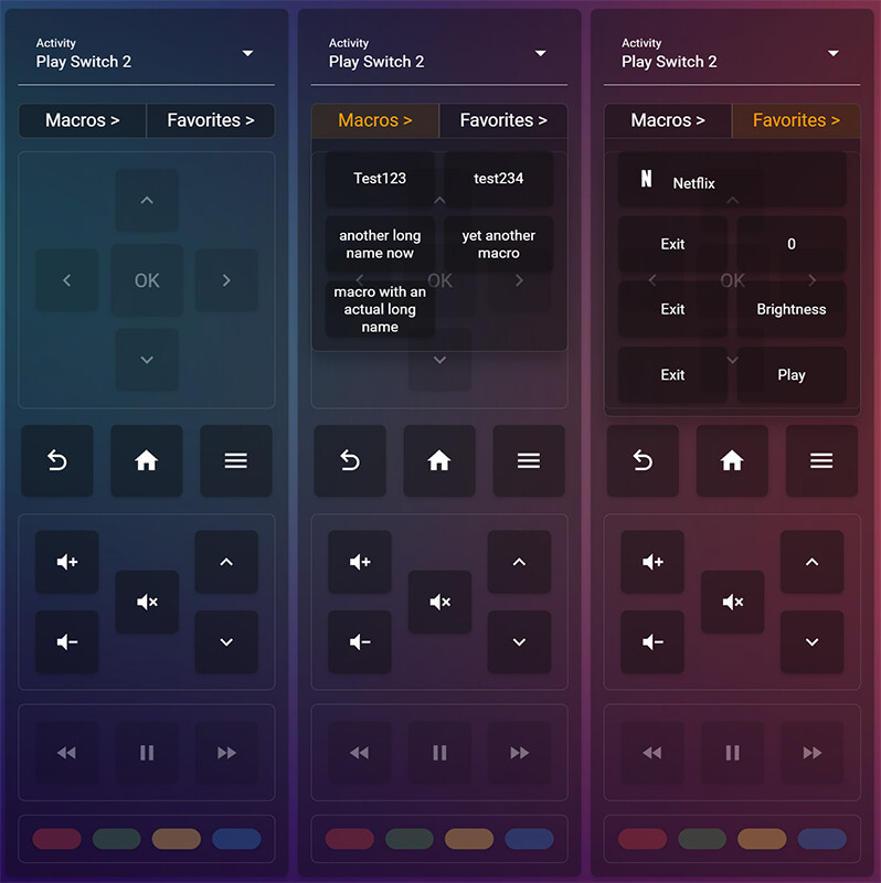

[Card] Sofabaton Virtual Remote for the X2, X1S and the X1
A highly customizable virtual remote for your lovelace dashboard.
It works with the Sofabaton X1, X1S, and X2 remotes.
:sparkles: Features
  • It’s your remote, in Home Assistant: Mirrors how you’ve set up your physical remote, including macros and favorites.
  • Works with all Sofabaton hubs: Compatible with the Sofabaton X1, X1S, and X2 hubs.
  • Theming friendly: The virtual remote plays nice with your dashboard’s theme, or override it for a different one.
  • Custom Layouts: Show only the button groups you need (D-pad, Volume, etc.), and change their order too.
  • Custom Favorites: For the virtual remote only: make your own favorites that send any command or call any Home Assistant action.
  • Responsive Design: The card scales to however much space it has. Tweak its behavior by setting a maximum width.
  • Configure via the UI: No need for YAML*. (*except for custom favorites)

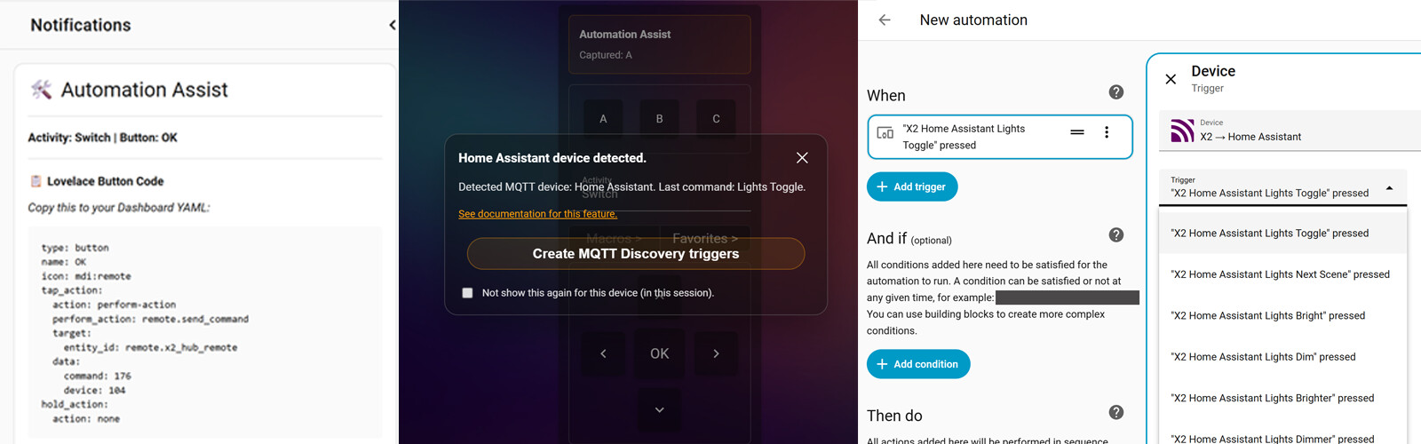

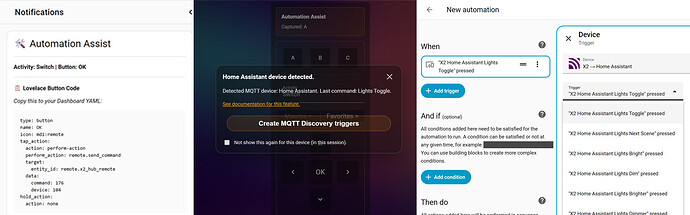

  • Automation Assist, a feature intended for making your own buttons and automations a little bit easier.
    • For X1/X1S/X2 users: Record your keypresses and receive ready to paste YAML for your Dashboard and Automations. Each button press is delivered as a Notification to your Home Assistant’s side bar.
    • For X2 users: if you have configured a Home Assistant/MQTT device on your remote, Automation Assist detects when one of its “buttons” is pressed (either with the physical or virtual remotes or the app). It will then give you the option to create MQTT Discovery Triggers. Read about that here.

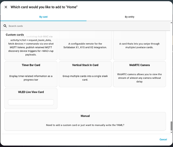

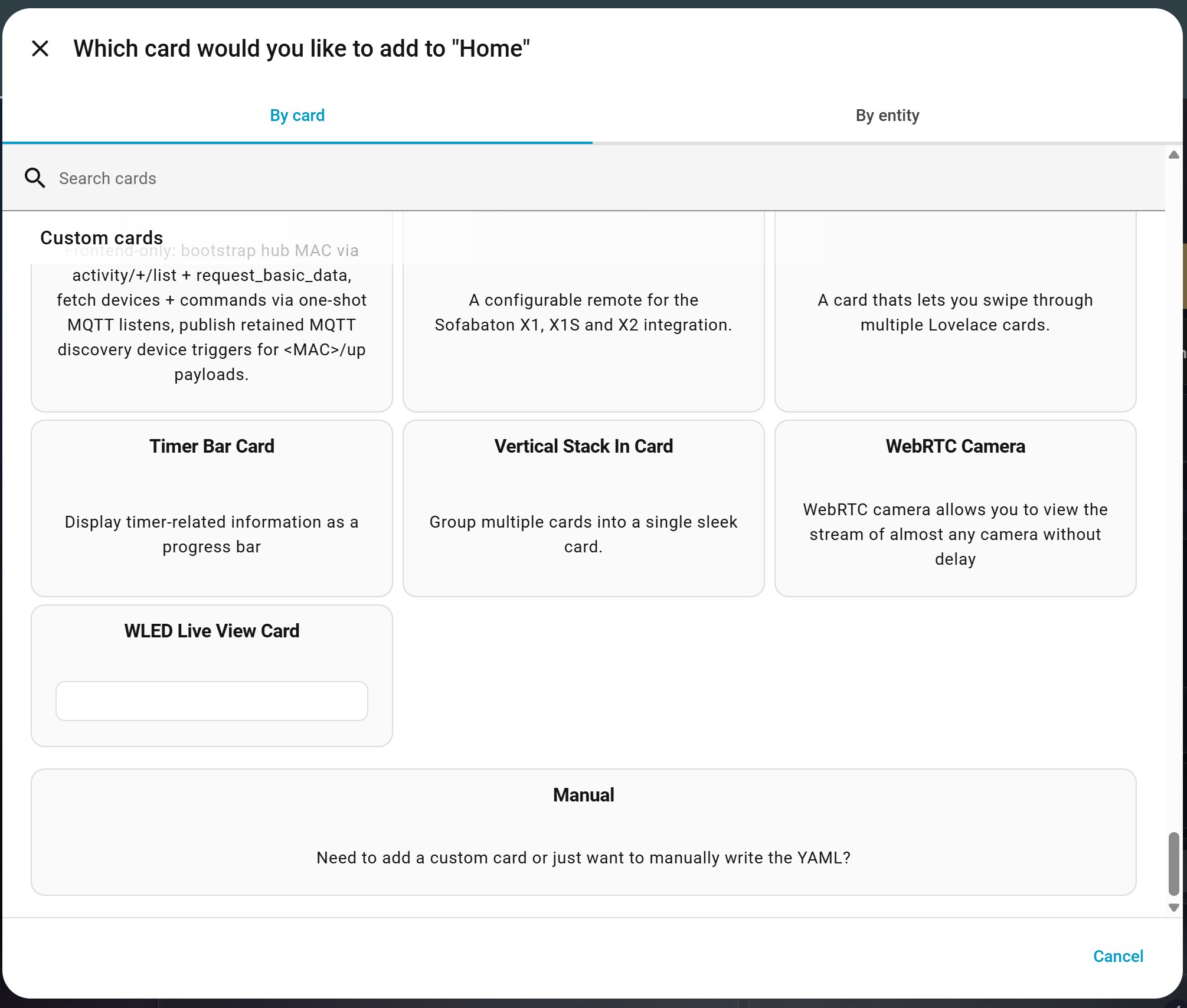

hello @Tomahawk. I should make that more clear from within the application. This is how you do it:
Click Add Card in your dashboard. In the Card selection menu, scroll all the way to the bottom and select Manual:
Then whatever YAML/text you see in the text box, replace it with what you copy from the notification, like this:
After pasting in the YAML from the Notification, you can then click that Show visual editor link. You can then customize further using the UI.
Hit Save and there is your button.

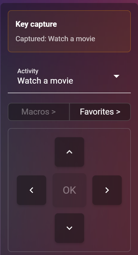

In the configuration editor of the remote card, enable “Key capture”.
Exit Edit Mode and your remote will look something like this:

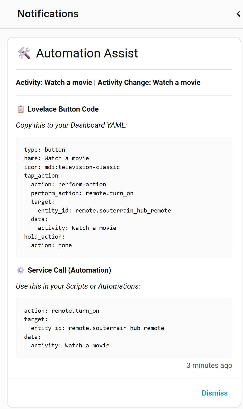

(You made me find a bug!) First click any button (this actually starts capturing keys… the bug is that it doesn’t do that on Select changes). Now switch to any Activity. It will look something like this:
When you see this, a Notification will have appeared in your Home Assistant sidebar.
To create a button that will switch to that Activity, this notification contains the YAML that you need.
To use it, put your dashboard in Edit Mode and click Add card, scroll all the way down in the card selection menu, and click Manual. In the textbox, replace whatever text that is there with the complete button YAML. In my example, I paste:
type: button
name: Watch a movie
icon: mdi:television-classic
tap_action:
  action: perform-action
  perform_action: remote.turn_on
    entity_id: remote.souterrain_hub_remote
    activity: Watch a movie
hold_action:
  action: none
You can then click the Show visual editor button to do more customization using the UI.
