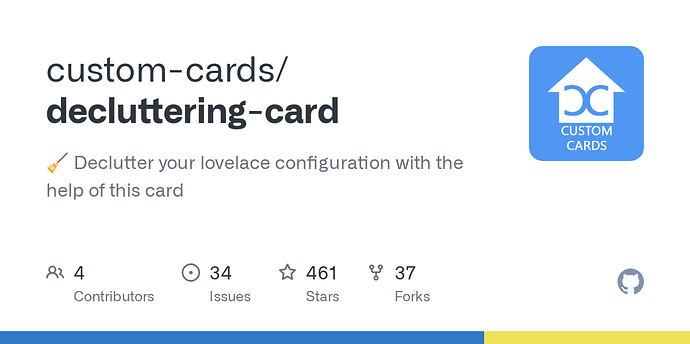

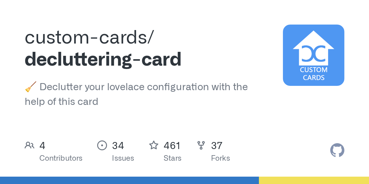

Method Two: Decluttering Card
Since Method One only applies to the custom:button-card, I use this method for other card types or when working with multiple cards. This approach allows the user to create templates that define entire cards, not just individual parameters like the button card template method.
Below is an example of how I use it. The first section is applied directly to a grid card on my dashboard. For each card in the grid, I reference the same decluttering card template but define the variables differently based on each card’s purpose. The second section contains the actual decluttering card template definition, which is added after the title: line in the “Raw configuration editor” of the dashboard, just like the button card template section.
If you are using both methods, place the decluttering card template section first and the button card template section after it.
