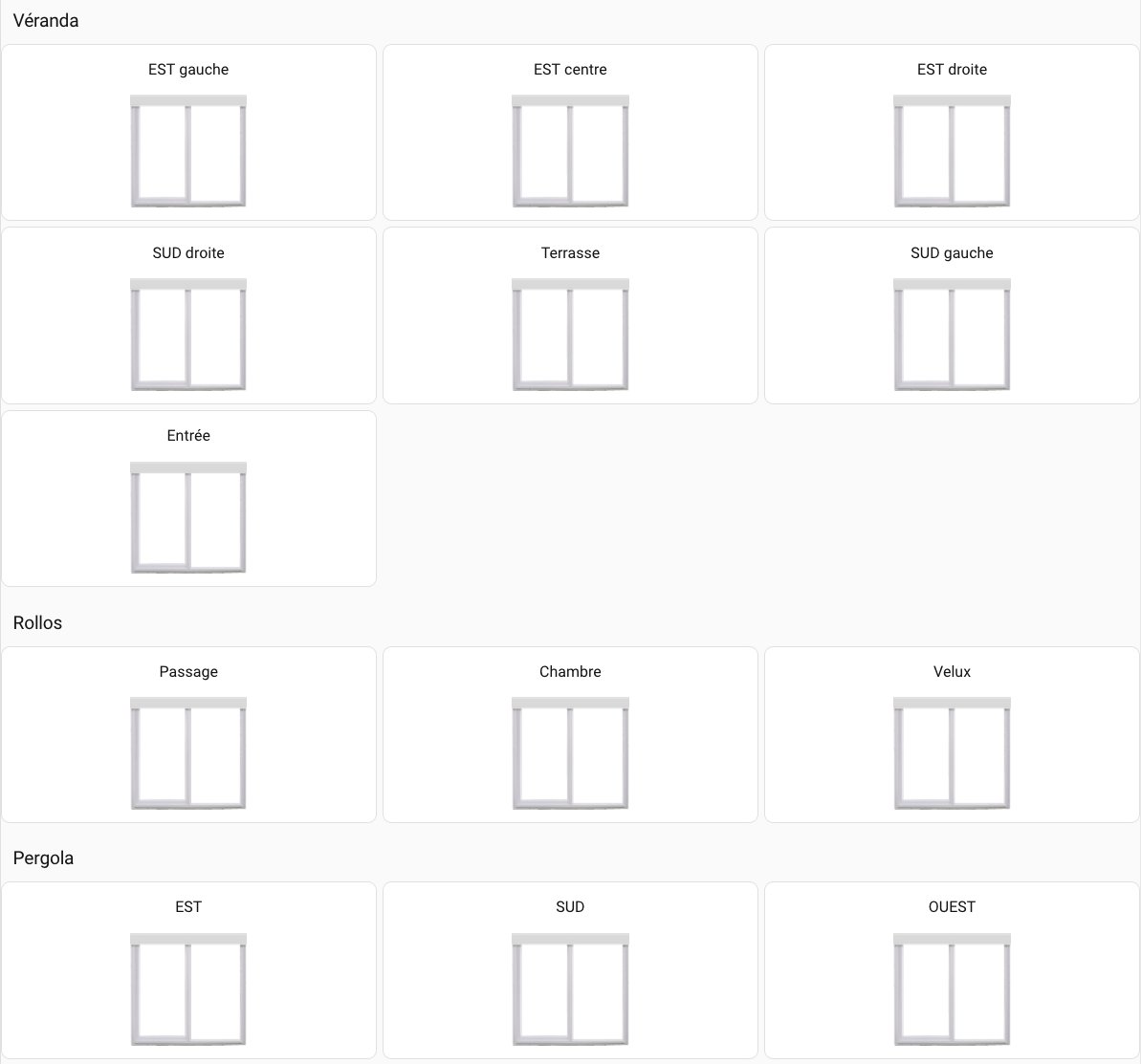

  • cover platform: Casambi blinds/shutters exposed as HA cover entities (open/close/position)

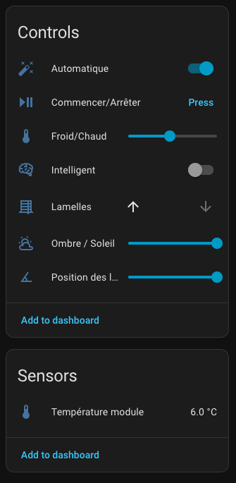

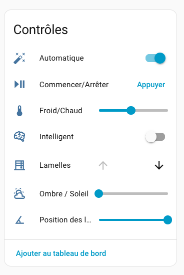

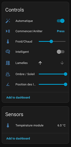

  • cover platform: Winsol Lamel venetian blinds with louvre position slider in degrees (0–142°)
  • switch platform: Automatique / Intelligent switches for Winsol Lamel Intelligent (Star)
  • button platform: Commencer/Arrêter toggle button (louvres 0°↔142°)
  • number platform: Shadow/Sun (%), louvre position (°), Cool/Warm (°C) sliders

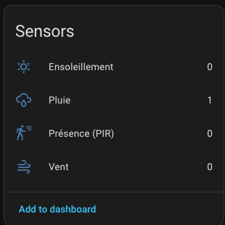

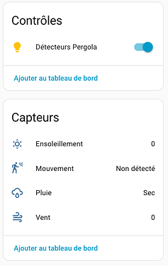

  • sensor platform: environmental sensors for Sensor Platform V4 (wind, solar, rain, PIR) + Lamel module internal temperature

  • The rain sensor currently shows raw values (1 = dry, 5 = rain — to be confirmed through weather observation). A fix will follow.
  • The PIR sensor always reads 0. Not sure I’ll have any way to use it. I think there’s no PIR sensor connected to the module on the Winsol pergola.
  • The lamel main entity sliders need some creative work. I’ll improve them.

Rain sensor: I noticed only two values: 1 for no rain and 5 for rain
Yes as said on my post, rain I will fix it during the weekend :blush:. I needed some rain to be sure.
As per wind, I don’t know the unit. It’s the same as in the casambi app. My guess is it’s indeed kmh.

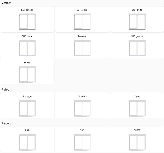

For the covers ? There are no stop button in the casambi app. You select the % of where you want the cover to be. At least for my winsol modules.
I’m used to use the slider of the entity (if you click the cover, you get a slider). I made myself a cover dashboard…
And for automation, I use %

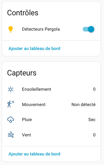

  • Environment sensors (fix) — rain and PIR were exposed as SensorEntity; converted to BinarySensorEntity with device_class: moisture and device_class: motion respectively. Also fixed an AttributeError on wind and solar sensors caused by missing SensorEntity property overrides (state_class, native_unit_of_measurement, etc.) — TypedEntityDescription does not extend SensorEntityDescription, so HA’s cached properties were raising instead of falling back

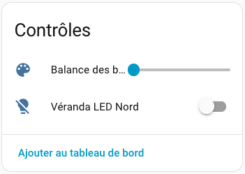

  • White Color Balance (new)white_balance attribute on the light entity, casambi_bt.set_white_balance service, and a number slider entity using translation_key

Rain and PIR sensors are now correct. Yet again, not sure PIR sensor on Winsol is used. ^^
I have added WhiteColorBalance to Arditi RGB-TW modules.
0% = 0 white in the color
100% = full white (remove color completely)
venitian pergola cover has been improved. Now there is a separate slider for blade position (0 to 142°)

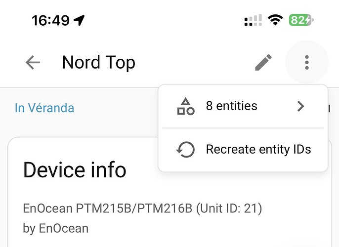

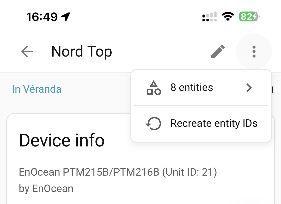

Please the following fir your occhio and enocean:
Click the device, click the menu and “recreate entities”
Let me know if slider is still.missing and if buttons order still wrong.
Recreated entities as you suggested, reinstalled 1.9.0-dev3 for good measure, same behavior:
  • PTM216B same switch assignment, tried on a couple of switches (as said, no big deal for me)
  • Occhio Mito vertical distribution entity not provided

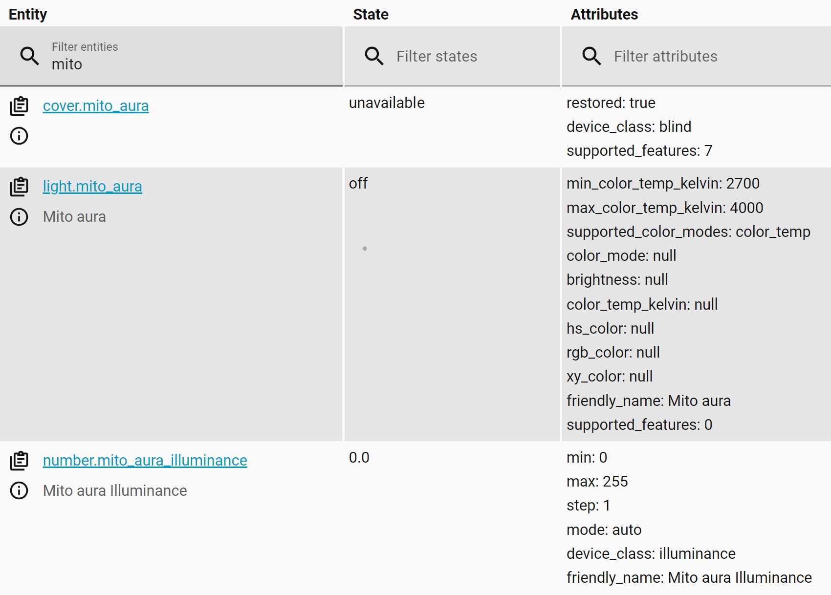

Can you share de details and attributes of your occhio mito in HA ?
and is it correctly seen as a light now ?
Here the entities and attributes of the fixture, with the “cover” standing in for the vertical light distribution. “Light” is the on-off switch. “mito_aura_illuminance” is the dimmer.
ok, Got it. prerelease 1.9.0.dev4 has been released.
Thank you. Just fixed it. I fine tuned the cover filter to avoid catching wrong devices. The new filter is: EXT/1ch/Dim + DIMMER AND No other light controls = Covers
So now, if TEMPERATURE or RGB or VERTICAL is found, it will never be considered a cover.
When you update to v1.9.0.dev4, you should first delete the faulty entity. If you can, best might even be to remove entirely your casambi network, update the integration, and then restart HA. Adding the network should recreate all your entities correctly.

cover.mito_aura was unavailable in 1.9.0dev3 (and *dev2 also), after deletion of Casambi network and upgrade to 1.9.0dev4, "cover"does not show up as entity.
Going back to 1.9.0dev1 by rankjie, entity is back as cover with attributes
device_class: blind
friendly_name: Mito aura
supported_features: 7
current_position: 100
Let me know if (and how) i can further assist in this.
