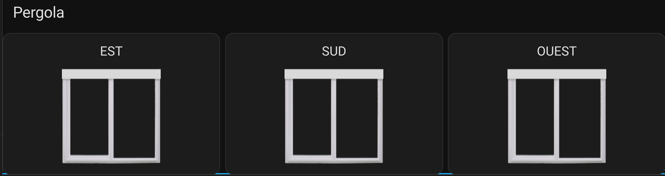

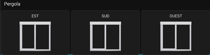

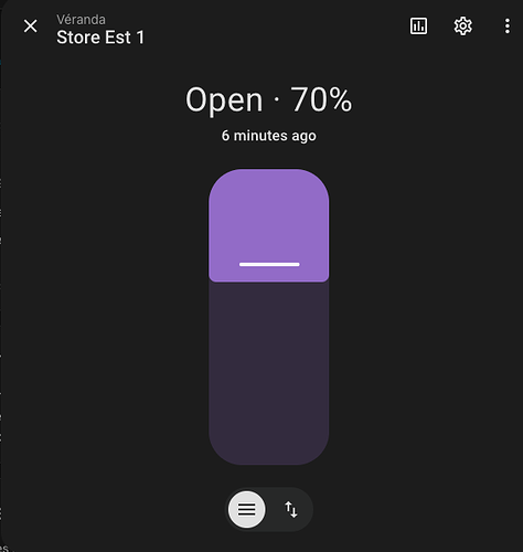

Hey. No I didn’t. I have integrated the covers from my pergola in Home Assistant using the blind card and the Casambi light entities generated by the integration. Here, the light.entities are Casambi covers, and the cover.entities are Motion Blinds covers.
I made a little customization to the card code to make it slicker but I didn’t publish the changes. I should do a backup thou :roll_eyes:
I planned to make tests and collaborate to the repo but I’m not confortable enough yet with python and github. It’s a lot of work to get there. I’ve plenty difficulty to understand the very complex modularity of the code.
I’ve been focused on another integration and a plugin for Obsidian for other topics meanwhile.
Here is my cover dashboard:
square: false
type: grid
cards:
  - square: false
    type: grid
    cards:
      - type: custom:blind-card
        entities:
          - entity: light.store_est_1
            blind_color: "#383E42"
            invert_percentage: true
        entities:
          - entity: light.store_est_2
        entities:
          - entity: light.store_est_3
        entities:
          - entity: light.store_sud_4
        entities:
          - entity: light.store_sud_chien
        entities:
          - entity: light.store_sud_2
        entities:
          - entity: light.store_sud_entree
    title: Véranda
    columns: 3
  - square: false
    type: grid
    cards:
        entities:
          - entity: cover.rollerblind_0003
        entities:
          - entity: cover.rollerblind_0004
        entities:
          - entity: cover.velux_external_cover_awning_blinds
            blind_color: white
    title: Rollos
    columns: 3
  - square: false
    type: grid
    cards:
        entities:
          - entity: light.store_pergola_est
        entities:
          - entity: light.store_pergola_sud
        entities:
          - entity: light.store_pergola_oues
    title: Pergola
columns: 1

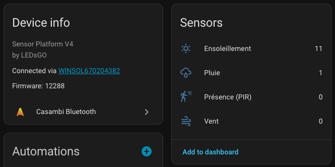

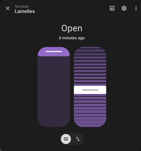

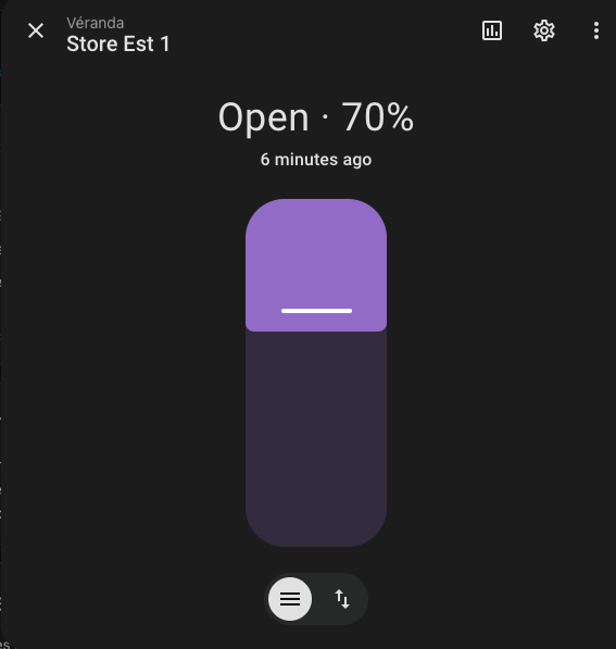

I pushed a PR yesterday to fix a bug and to add covers. I have covers from Winsol powered by LedsGo modules. The PR considers EXT devices as non light devices. This seems to be the consensus from a Casambi stand point.
What’s new in this PR:
Winsol covers and pergola lamels are now recognized and working.
I’m currently working on adding the Winsol sensor for Sun, Wind and Rain (Also PIR, but I’m not sure there is the PIR receiver connected. I’ll have to test. otherwise I’ll have to forget about that part unless someone can provide the raw value for PIR)
So: Covers: working in PR
Lamels: working fine, but would need some improvements. Working on it:
Sensors: Work in progress: Will be in next PR:
Rain is wrong. But there is no rain today. I have to way to find out the right value.
Sun and Wind work perfectly
As said: PIR: not sure I will ever know the real value, as I’m don’t think there is the PIR required sensor connected.
