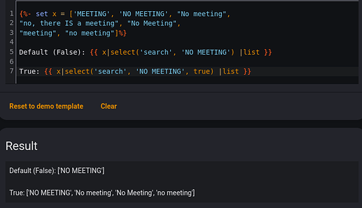

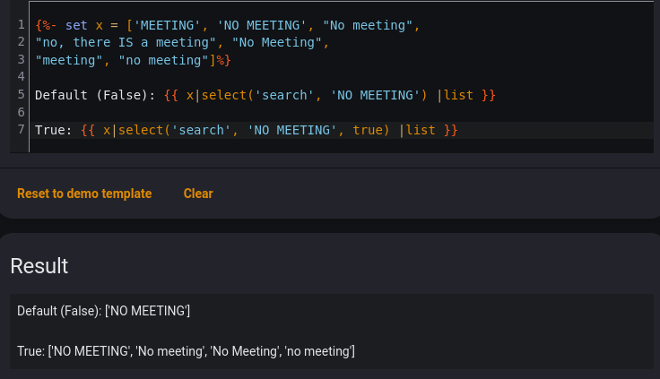

The search test has an “ignore case” arg that is false by default, you can set it to true in the select filter as follows:
| select('search', 'NO MEETING', true)
Wow, two solutions! Thanks for the prompt responses, @d921 and @Didgeridrew. I’m marking @Didgeridrew’s as the solution purely since it’s a simpler tweak but it’s great to know there are a couple of ways of doing it.
