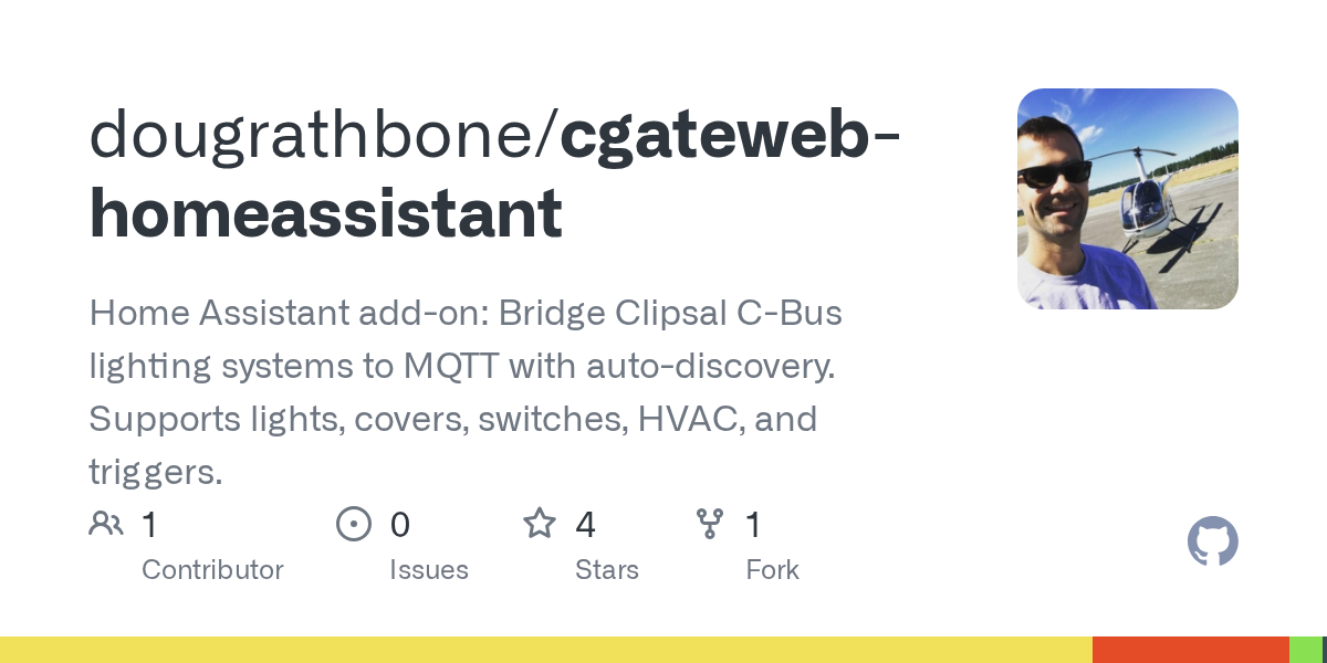

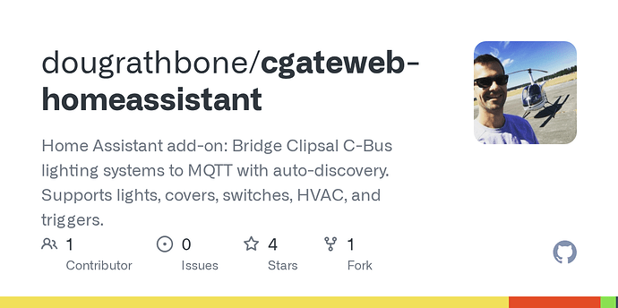

Hey!
If it’s helpful I have a dedicated home assistant addon you can find here:
The source code is here: GitHub - dougrathbone/cgateweb: MQTT interface for C-Bus written in Node.js · GitHub
This should give you light, cover and hvac support, along with device autodetection over mqtt.
