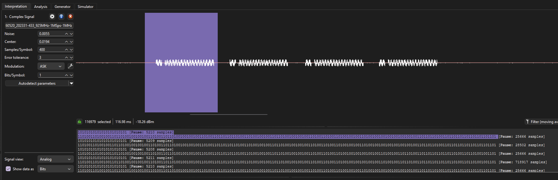

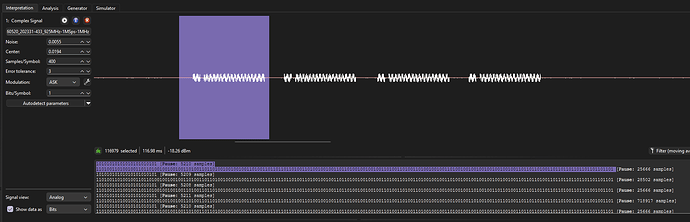

I tried a different approach tonight. I have an rtl-sdr and downloaded URH, I did a quick capture and something hit me like a ton of bricks! The capture showed a set of pulses with a delay inbetween that was roughly -25000. I changed my approach in my snippit that I was transmitting and cut the raw down to 1 set of pulses, left the delay on the end of the raw code and repeated it 4 times. It works now everytime! Before this change, it would work once in a while, now it works every time. It takes longer to turn the light off than it does to turn it on... but it is working.
Blockquote For example transmitter is coded to send pulse pair 400us HIGH, 800us LOW.
So, you are saying each pair should be 400. -400 or 400, -800 with the 25k being the pause before repeat? Could one just make them all either 400, -400 or 400, -800? So, in the case below should I have some kind of wait timer defined?
So, to me it looks like this is what I should be sending, some sort of preamble followed by a delay of around 5200uS followed by the command and a delay of 25000 to 28000 uS?

I tried the rtl-sdr again to check timings...
If we analyze the 3 captures you posted, we can see that they are not exactly same length. First capture has some error , so I use the second one.
Signal is composed of pre-amble (11 equal pulse pairs and 5ms gap) following actual data (65 pulse pairs) and 25-27ms gap.
There are two complete repeats and third one that is truncated. Probably by RMT-symbol memory.
You could try to get the whole transmission by adjusting RMT parameters.
Or just simply send single packet trying different repeat times:
