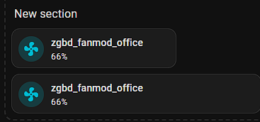

Hello ! In the Climate Dashboard (canned HA dashboard) there is a very nice ceiling fan card -
But I can’t figure out how to place that type of card in my custom dashboards. If i insert a card based on the same entity, it only has one option and I can’t searching through all the options, I can’t get a similar feature set as the canned card

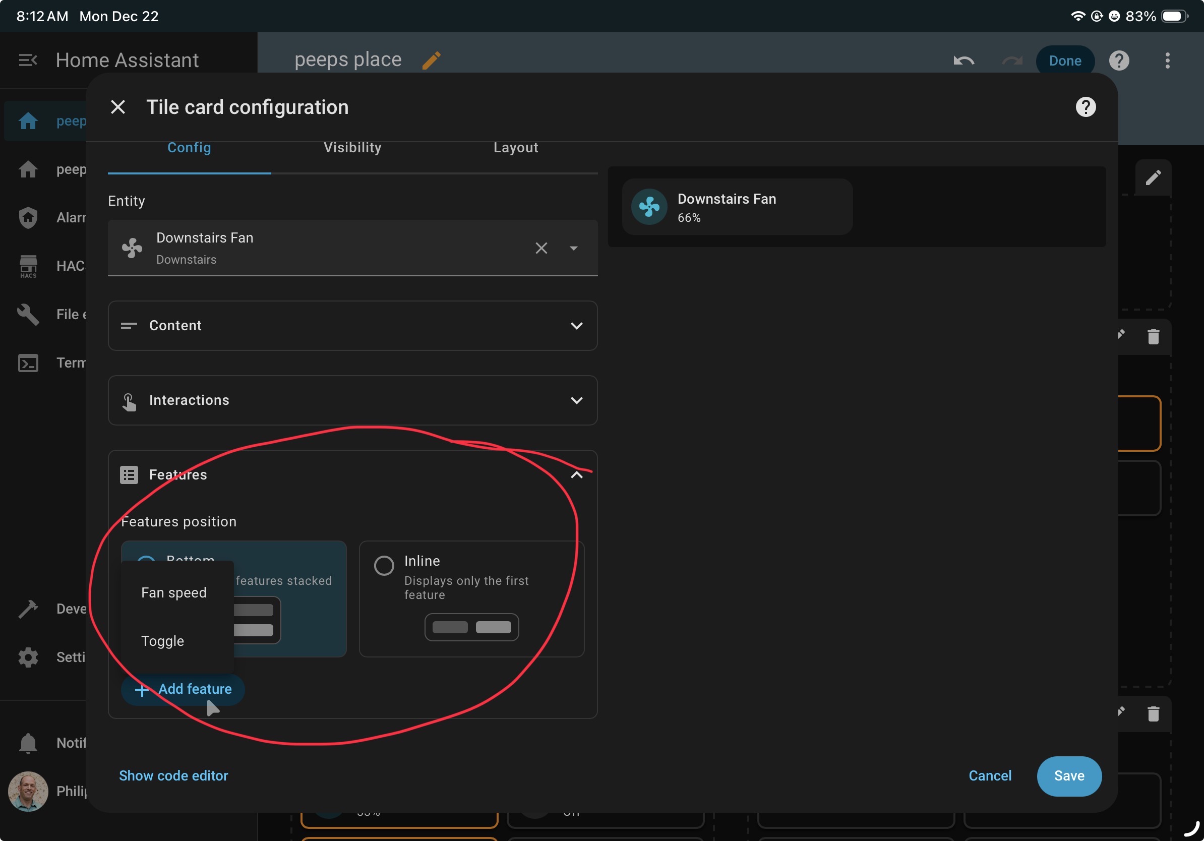

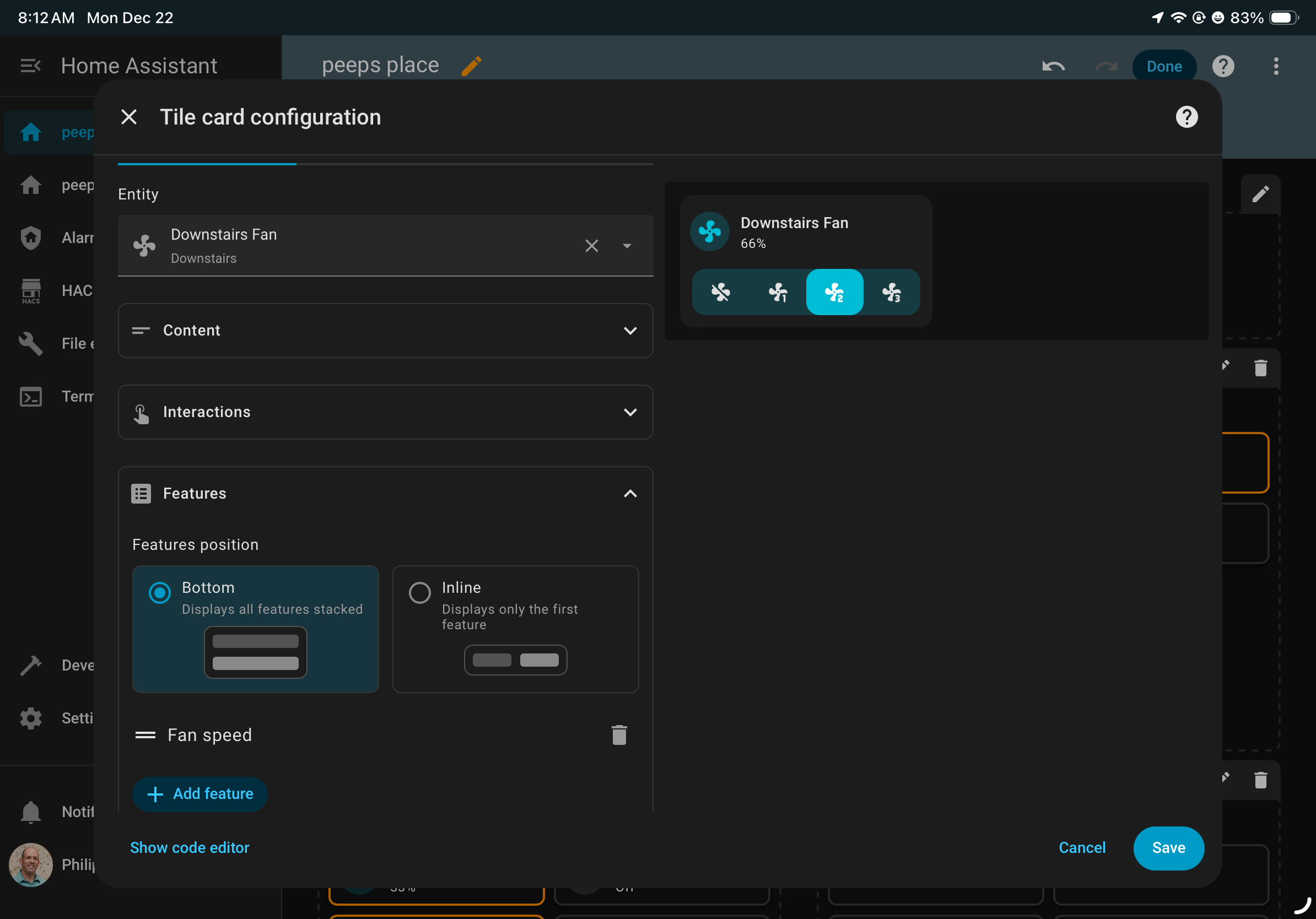

In your card, add the fan speed feature.
