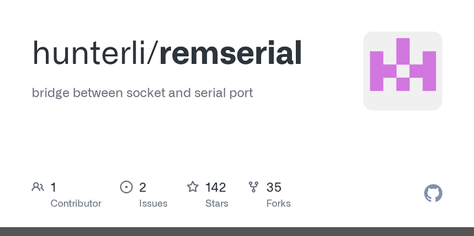

I have no experience with your tech stack.
However if you are building your own integration for anything that talks RS-232 I would recommend checking out RemSerial. Its just a small C program that handles the serial communication and exposes a TCP socket.
I switched over to it for two reasons:
  • I got fed up trying to deal with serial communication.
  • I can leave the device plugged in to one machine and if I want to debug from a different machine, I can just put the hostname into my editor/debugger and send commands over the network.
TL;DR - its basically becomes a “Network Attached Serial Port”.
