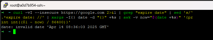

hi, thnx for looking into it, but i still receive the same error?
if i do a grep on date only, i have this output:
maybe you see it different?
Oh, sorry, I tested on the wrong terminal and didn’t realize that the second problem is that the version of date used in Home Assistant OS doesn’t support that time format.
