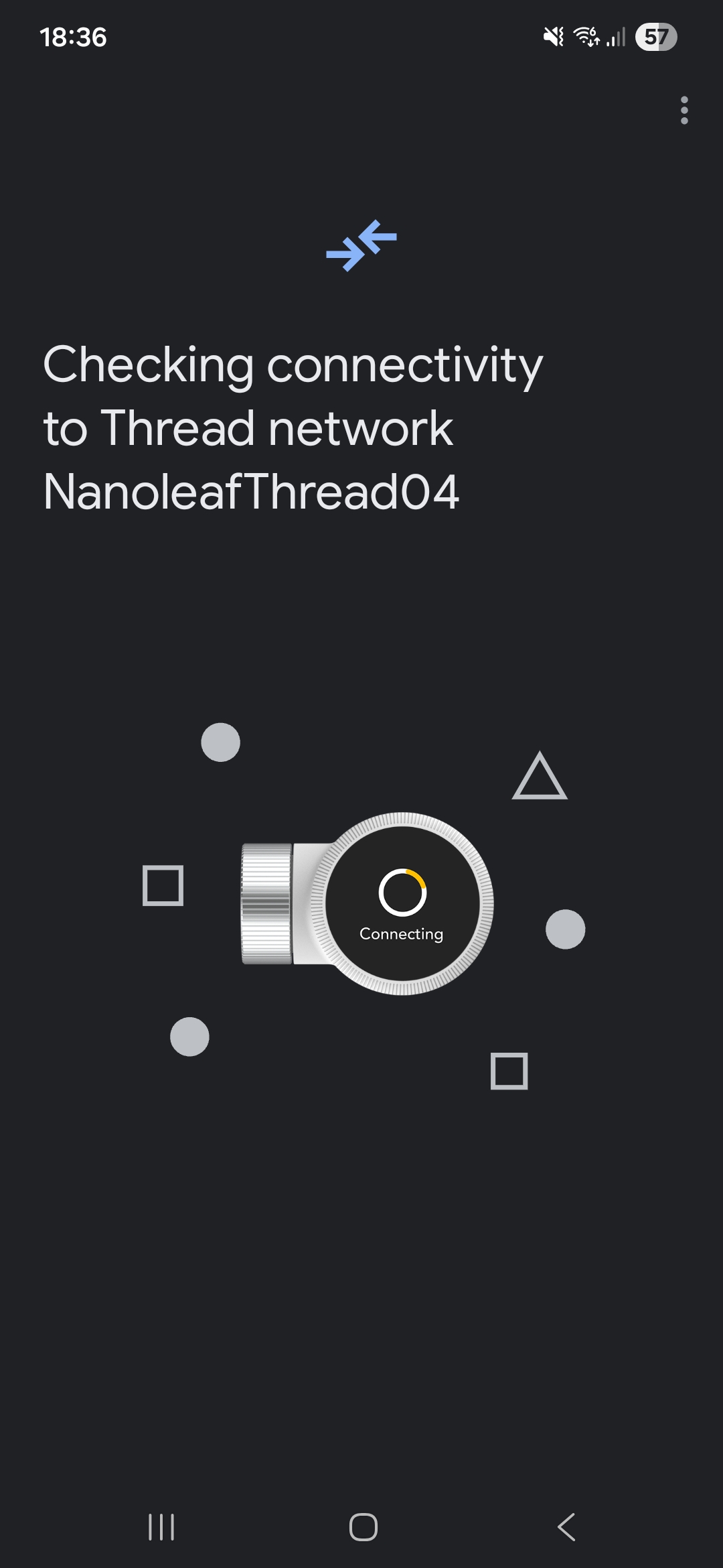

I also have a few tado thermostats that use thread, these are currently not working. So when trying to pair them from a factory reset state (deleting them and then adding them through the matter integration) the device is trying to connect to a non existent network…

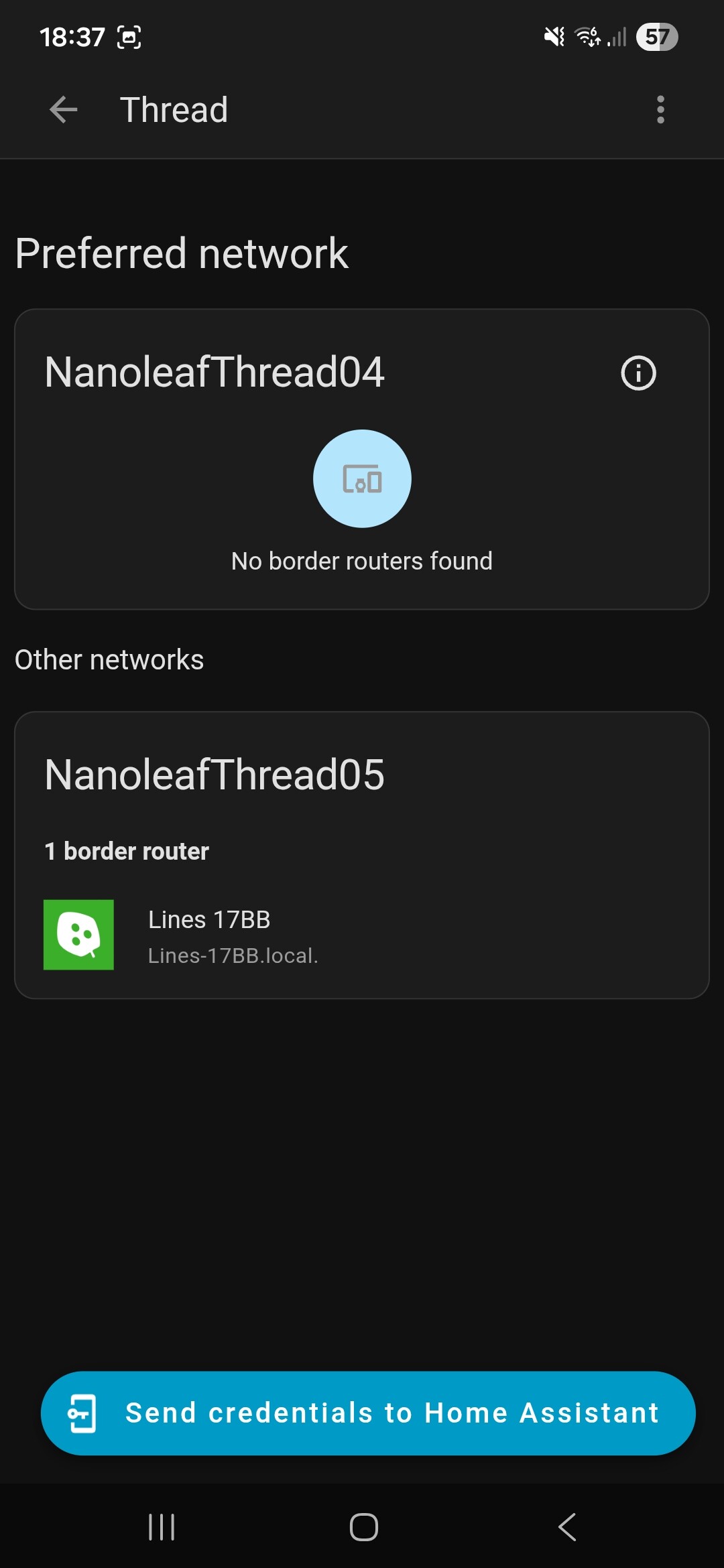

If I look at the thread settings in the android companion app I see…
There appears to be no way for me to make the new 05 one the default.

Sending credentials from the app (says it has worked) which I believe should give me the (I) in the corner to be able to select it as the preferred network.

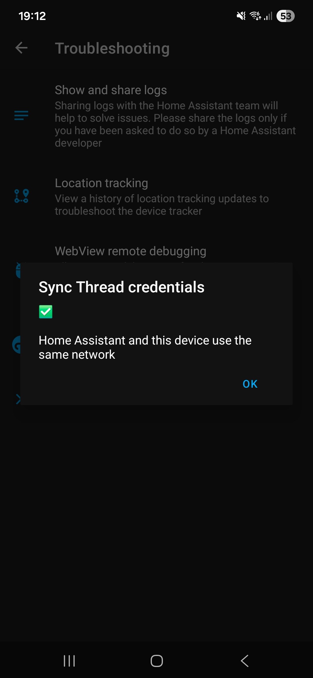

Sending the credentials from troubleshooting…
