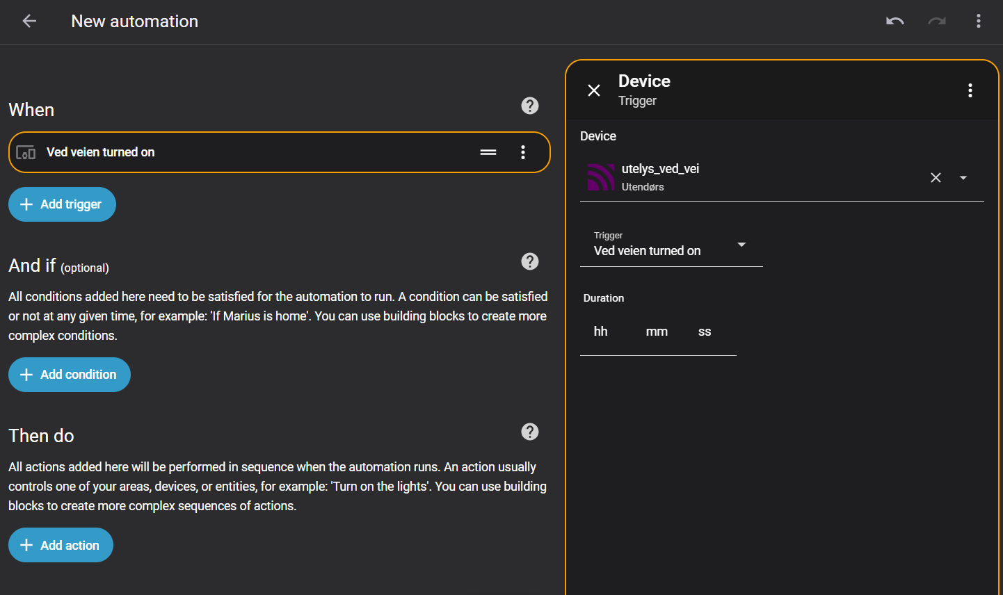

This results in the following code:

@MoneyPeet take a look at this Why and how to avoid device_ids in automations and scripts
Yes, that’s what I did.
As a beginner YAML is difficult to learn, and I think the GUI is a great way to start.
But when it comes to some more difficult settings, you need YAML.
And then you see all these ID’s and Devices with the long numbers.
Totally understandable - you can continue creating your automations in the GUI, by try with entities instead of devices (trigger using state), it will make a lot more sense to you when you look at the yaml :slight_smile:
This is a snip of an automation made in the GUI using entities and states, see how much more sense the naming makes:
