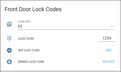

I need to display a entity in lovelace (input_number.lock_code) based on the value of another entity (input_select.code_slot).
First can this be done?!
Second, how in the heck can I make it happen?! lol
Below is an example of what I want to do…When I select the Code Slot from the drop down, I want the Lock Code to update automatically to the slot I just selected.
lock
Thanks in advance!
Look at the “conditional card”.
