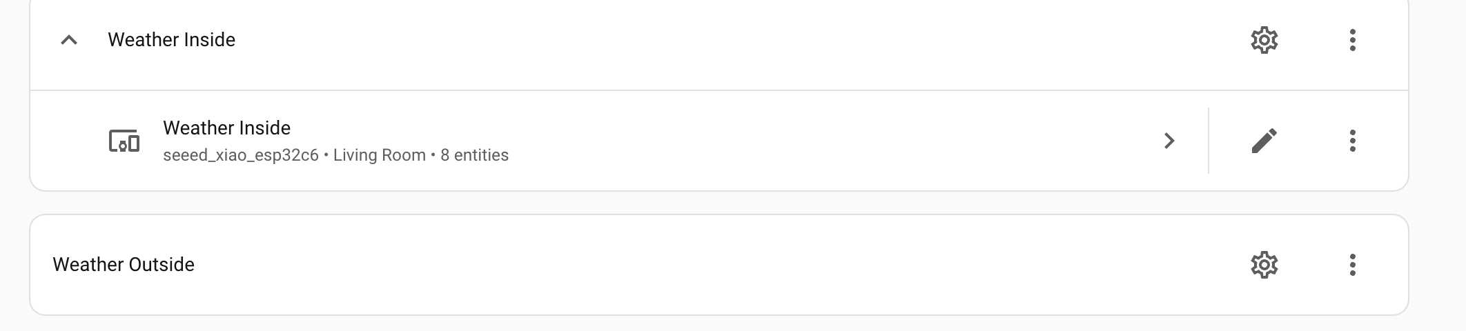

I then tried to add a new ESPHome device in the Devices and Services’ area. This time it did create a device BUT just adds an entry with the top line along the same lines as all of the other devices listed.
Also I note that the count of devices does NOT include the new one (it still shows 9 whereas the new entry is the 10th device).
