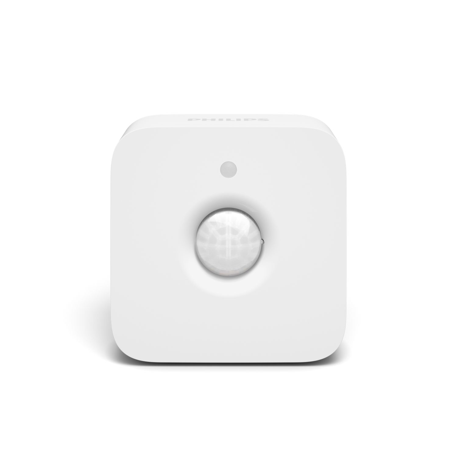

Ive got a philips Hue motion sensor....
:red_question_mark:
Please keep in mind that HA has more than 2500 integrations that support tens of thousands of devices and Phillips Hue has sold a variety of motion sensors over the years, so you need to be more specific.
Does your motion sensor have a luminance sensor built in...?
If it doesn't what other sources of data do you have that we could leverage to approximate light level? For example, do you have a weather integration running that supplies condition information?

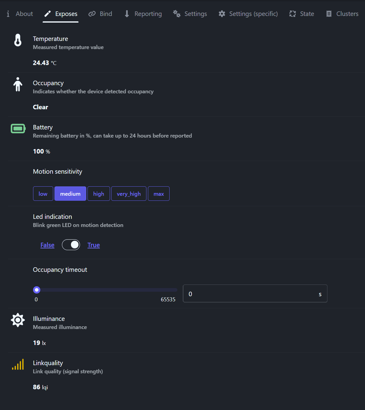

Since you already have one and it does have a numeric Lux value you may as well give it a go and see if you can get it working.
The key points are that:
  • You may need a small delay after the motion triggers to allow HA to receive the Lux update.
  • You probably want separate triggers for on and off since off doesn't need to consider the lux setting (it always turns off when clear).
Yeah - but thats the thing....when im in the automation and i go add in the threshold for light (or whatever setting it is) - i cant see anything that looks like that kind of value/option/function...
So yes it would be nice to try, just not sure where to find the option...
Please describe or post screen shots of what you are talking about. I think you are trying to use the luminance as a condition. To do that, in your automation add a Numeric State condition with the luminance sensor's entity ID in the appropriate field.
To find the entity ID:
Go to the Devices dashboard, find you Hue Motion device, click on it. In the page that open look in the "Sensors" section. Is there an Illuminance sensor? If there is click on it's name to open it's entity popup menu. Click the gear icon to open the entity settings, then find the entity ID field and copy that value.
