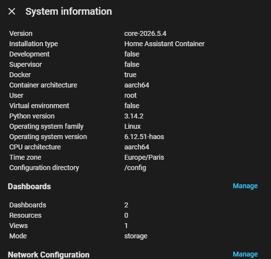

well i just unbox mine and it come with a container and i don't have access to app
I read somewhere this might happen if you fail to provide an ethernet connection with working internet., but I'm not affiliated to Nabu Casa so I'd contact their support. You could also try the factory reset on the support site with ethernet and internet connected.
Make sure that it's connected to the network via ethernet, then reboot (not restart) the green.
it worked, it seems my mesh was booting when the HAgreen was starting
