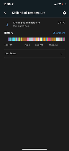

I have a homeseer system running that handles my z-wave network. Having issues with the z-wave stick so I have integrated the homeseer into HA.
But I have some issues with a temp sensor not showing up as a proper temp sensor. This is causing issues when using with the generic thermostat.
As you can se from the pictures below the value the sensor is sending is not only numeric. It has an added C to the value. The sensor is a Aeotech Multisensor 6
Is there a way to change this for the entity? Do I have to do this in homeseer?
