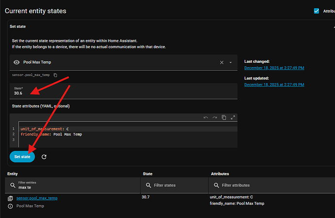

I have a custom sensor that reads the max temp of my pool so I can see how warm if got over the day. The sesor it reads that from occasionally gets a strange spike and hits 999 deg. So I wanted to see if I can use and automation to reset that max temp back to 0 so it will get a new value from the sensor again.
I have built and automation but I cant find an action to run to change the value. Is there a service call that I can use that anyone is aware of?
Pretty much I want it to do the same as me jumping in the dev tools and manually setting it to like this:

That is only a temporary change for testing purposes (e.g. testing a numeric state trigger).
You are not meant to change sensor states. You can filter them: Filter - Home Assistant
