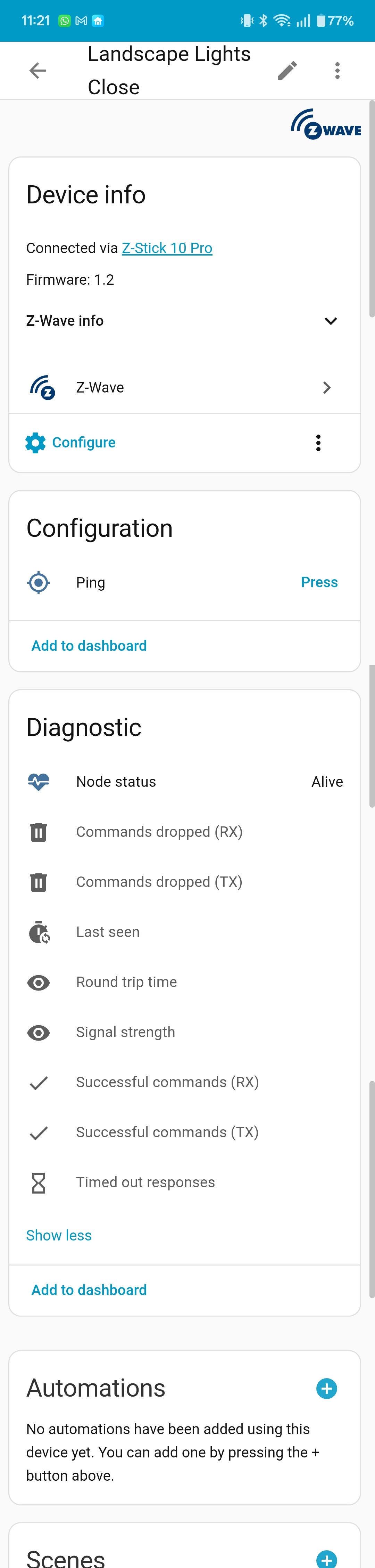

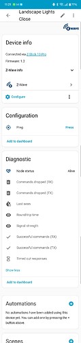

I am using Z-Wave JS UI. Switching devices over from Smartthings as a new HA user.
I have a bunch of old Iris Z-Wave plugs. I am able to add the plug using inclusion in ZUI but it doesn’t add as a plug or switch so there’s no way to turn the plug on/off.
Any way to fix this by changing the plug to the proper device type? Thanks!

Some of those plugs are combination Zigbee plugs with z-wave repeaters. It looks like that might be the case here, and you are getting the correct entities showing up for the z-wave repeater functionality. So now you need to pair it with your Zigbee coordinator via ZHA or zigbee2mqtt.
