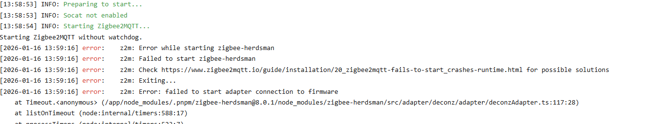

I have been using a Conbee II dongle with Z2M and wanted to replace the Conbee with a SONOFF PLUS-E dongle. I just switched the dongles and did a hard reboot of the HA server (HA Blue).
The new dongle is recognised.
But Z2M refuses to start. This is the log entry
Deconz is installed but disabled.
I understand that Z2M will not start if no dongle is installed or recognised, but that is not the case here. What to do?
Thanks for your help.
Taco
Post your Z2M config. You forgot to change the adapter type (the penultimate line shows it’s still trying to connect to a deconz [Conbee] adapter)& possibly the path.
