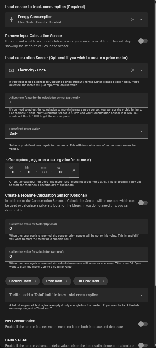

@cabberley Hi Chris,
I’m used to manually defining utility_meter(s) and groups in yaml to end up with a set of meters that are tracking the peak / shoulder / off-peak consumption (and if using energy_meter and a sensor for import / fit prices, then the $ also).
Trying to work out if and HOW to do this with your integration, any examples available ? Your readme refers to tariff periods etc, but I can’t see any where to do this. There is the box to enter tariff names, but not too sure how to setup the"
Peak = 7am - 9am and 5pm - 8pm (Mon-Fri)
Shoulder = 9am - 5pm and 10pm - 10pm (Mon-Fri)
Off-Peak = All other times / All Day Weekends
Thanks.

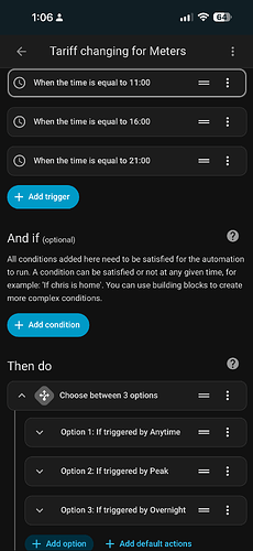

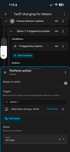

I use an automation that triggers based on the times when the tariffs change.
With each utility meter there is a select option to set which of the tariffs to track the usage and/or cost against. I labels/named each trigger then when the item time occurs the action changes the select for each meter. To save time I also group various meters I have so I don’t have to add them individually to the automation.

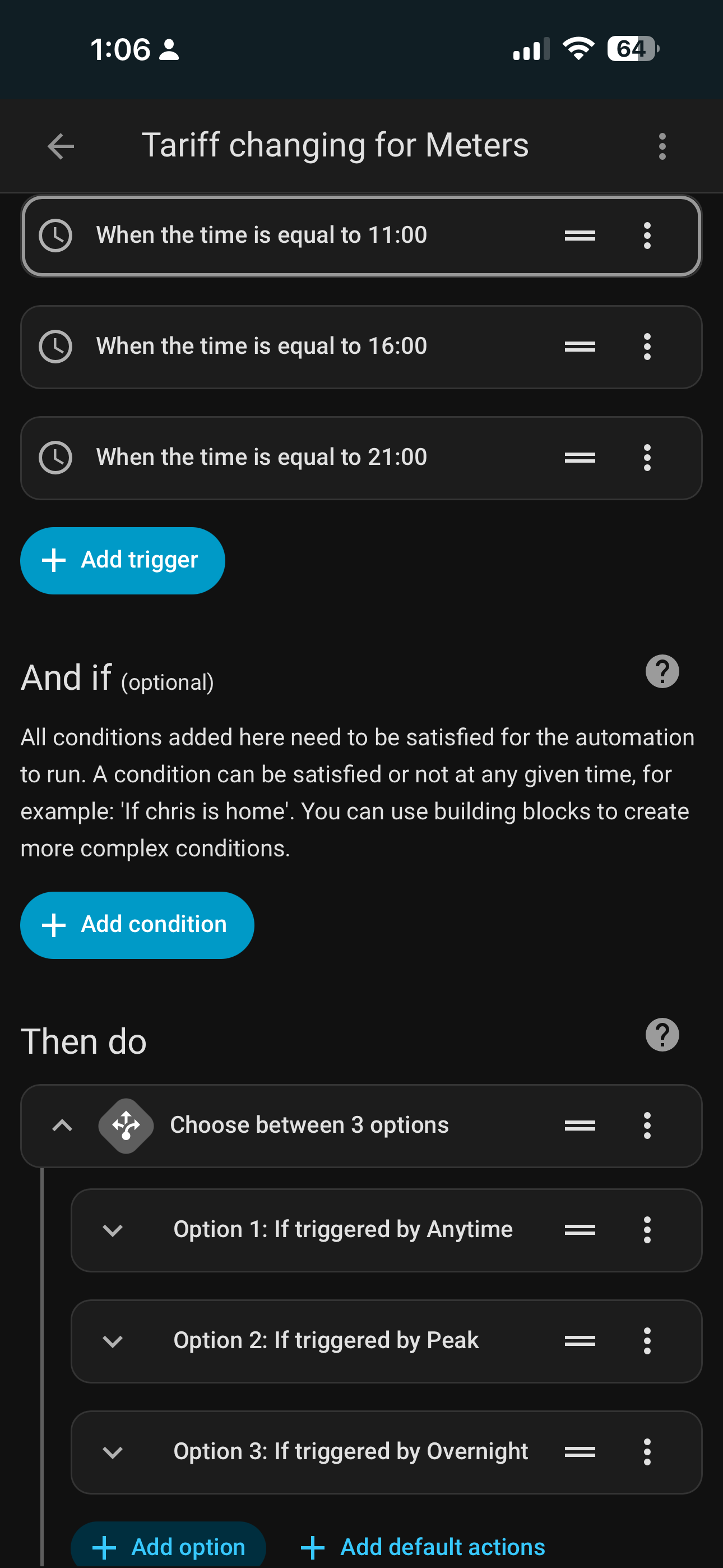

Didn’t think you’d reply so fast, so was looking at old code and realised an automation was needed. If anyone else wants an example for a tariff plan with:
Peak - Monday to Friday during 7am - 9am and 5pm - 8pm
Shoulder - Monday to Friday during 9am - 5pm and 8pm - 10pm
Off-Peak - All other times
alias: Energy Consumption Meter - Set Electricity Tariff
description: Set Electricity Tariff depending upon the day of week and time
triggers:
  - trigger: homeassistant
    event: start
  - trigger: time
    at:
      - "07:00:10"
      - "09:00:10"
      - "17:00:10"
      - "20:00:10"
      - "22:00:10"
conditions: []
actions:
  - choose:
      - conditions:
          - condition: time
            weekday:
              - mon
              - tue
              - wed
              - thu
              - fri
          - condition: template
            value_template: "{{ (7 <= now().hour < 9) or (17 <= now().hour < 20) }}"
        sequence:
          - action: select.select_option
              entity_id: select.energy_consumption
              option: Peak
        alias: PEAK - If Monday to Friday and 7-9am or 5-8pm
      - conditions:
          - condition: time
            weekday:
              - mon
              - tue
              - wed
              - thu
              - fri
            value_template: "{{ (9 <= now().hour < 17) or (20 <= now().hour < 22) }}"
        sequence:
              option: Shoulder
        alias: Shoulder - If Monday to Friday and  9am - 5pm or 8 - 10pm
    default:
          option: Off-Peak
        alias: Off-Peak - All other times
mode: single
This is based on the Next Gen meter being called ‘Energy Consumption’ (giving you an entity select.energy_consumption that has the aforementioned tariff rates defined in it) and if you then select the option for ‘Create Multiple Predefined reset cycle meters’ and then select the Daily / Weekly / Monthly / Yearly etc options, you’ll end up with meters called ‘Energy Consumption Daily Peak’ / ‘Energy Consumption Weekly Shoulder’ etc.
