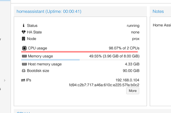

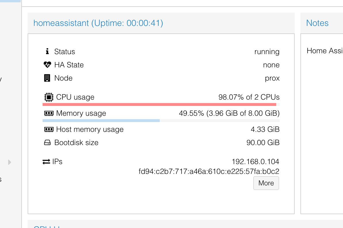

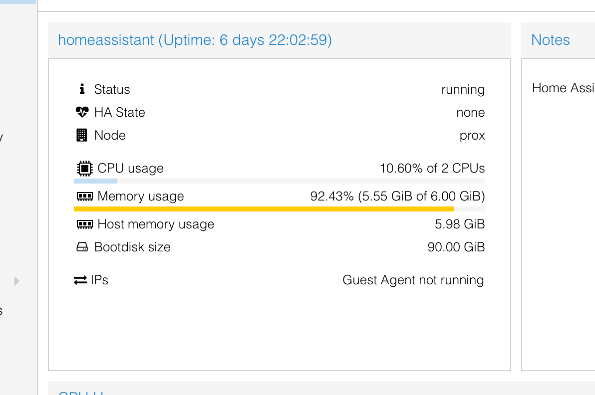

My HAOS vm has 6GB RAM:
I shut it down, added 2GB and it booted up again without any issues.

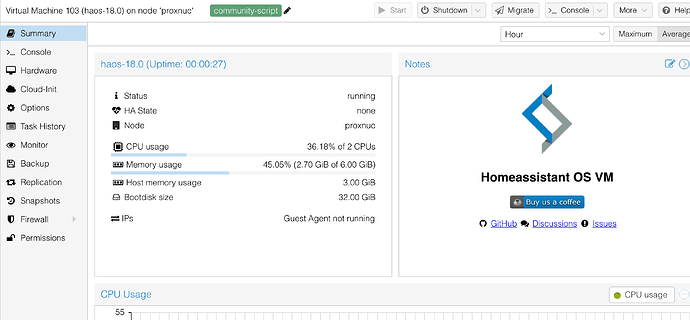

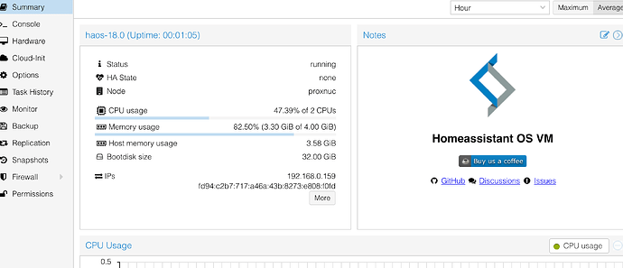

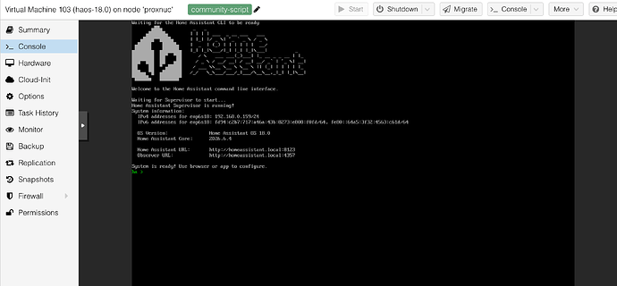

But since you ask so nicely, freshly deployed vm using the script:

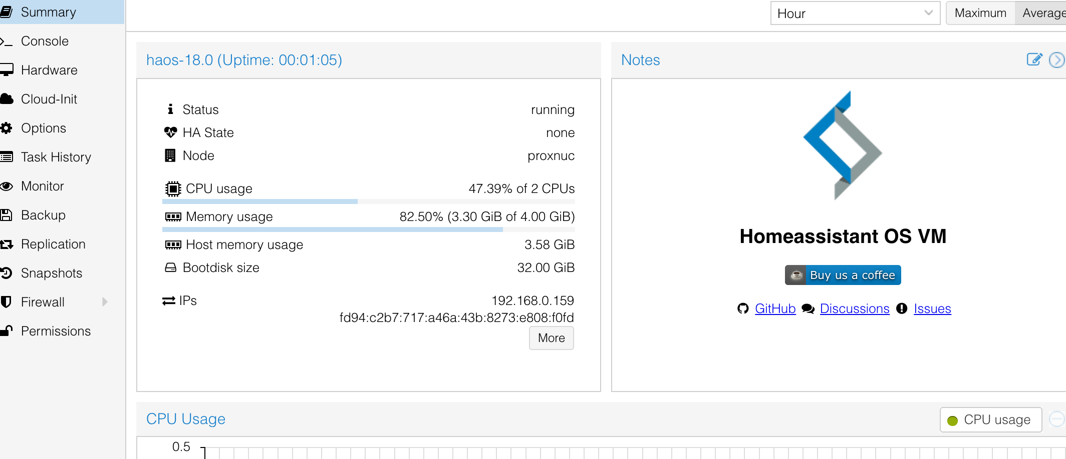

after RAM increase:
Booting just fine:

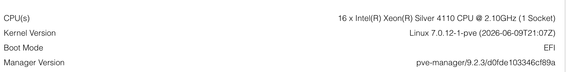

Proxmox:
Thanks! So it looks like a me problem. :sad_but_relieved_face:
