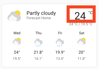

Changing the font size for temperature in the Weather Forecast card using card-mod
I’m using card-mode in order to add some CSS styling to cards on my dashhboard.
I want to increase the font size for temperature in the Weather Forecast card using card-mod, but doesn’t matter what I try in doesn’t work.
Any help would be appreciated.
@Gregkg thank you so much mate. It works like a charm.
