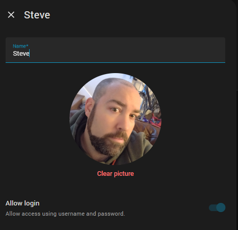

When I log in, I see my user’s display name and avatar in the lower left corner of the browser window:
When I see my person entity, It has an entirely different avatar:
I can see where the person avatar comes from. I can change it right there in the settings dialog. But that user image is coming from somewhere.

From what I can tell the only way you get a picture there is:
We iterate over all person entities and find one with a userid that matches the current logged in userid.
We use the picture from that person entity’s entity_picture.

No I’m saying that people have pictures, users do not. You can easily verify this on the users tab. The picture you see in the lower left should be the picture from the person attached to the user that’s logged in.
Upon finding that my user image is located in my www folder (local in the URL), I’m even more sure that I would have configured this image manually for the user at some point. Also, the date on the image file is in 2019, so it’s definitely been there for a while.
Restart in safe mode and see if the user profile picture changes to match your person image. If it does then you have a 3rd party resource of some description loading the user picture.
Maybe check for entity_picture overrides in customize
