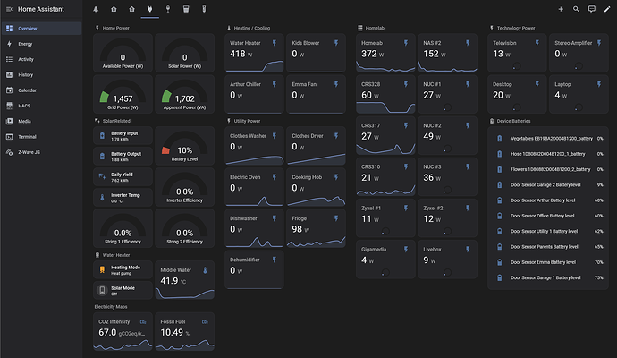

I have a few tabs with a lot of graphs (default widget from Lovelace) and it tends to take a few seconds to show all the data.

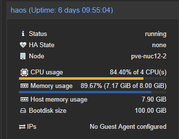

Home Assistant is visualized on Proxmox on a NUC12 with 64GB / Enterprise NVMe / Ceph RBD.

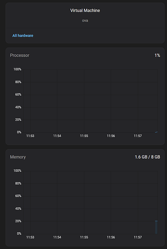

I checked CPU usage and while loading the tab with the most charts, I noticed the CPU was hit hard.

Are those all built-in cards? Perhaps reduce the number of cards as a test to see if it improves performance.

Memory usage is very high, especially for 8GB allocation. But this might be how Proxmox allocate it to VM rather than real usage within VM. I run my HA on ESX with 4 cores and 4 GB of RAM and while all RAM is marked by host as used, only 30% is active. I have quite large instance with 3500+ entities.

Those are built-in cards, I’m trying to stay away from too heavy customisation to avoid issues while upgrading HA.

This is perfectly fine, HA tends to use as much memory as you give it. Inside HA, the memory consumption is fairly low.
