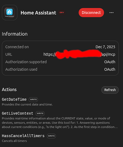

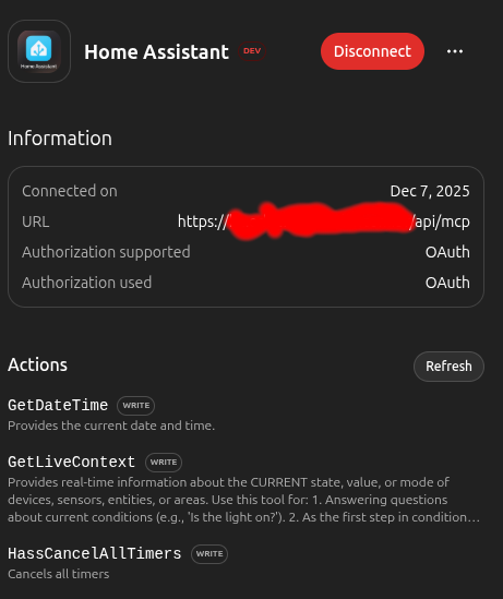

What works so far
  • :white_check_mark: The MCP Server is configured and discovered by ChatGPT.
  • :white_check_mark: The OAuth flow completes successfully (authorization step works end-to-end).
  • :white_check_mark: The available tools from the Home Assistant MCP Server are listed correctly in the client (for example, I can see a GetDateTime tool exposed).

After a few hours, I tested again, and it simply started working.
Maybe there was some kind of “synchronization” delay when adding a custom connector, but now everything is working correctly — including write actions like turning lights on and off.
Results are more reliable when clicking the “plus” button to explicitly request the MCP Server to execute the action. Still, the AI also does a good job of inferring when to use it, even when not expressly instructed.
