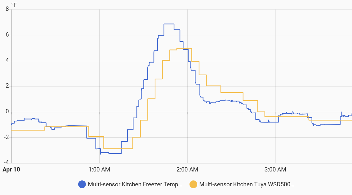

First example: I have some of those Tuya/Zigbee temp sensors that use AAA batteries, I wanted to try these since the temp sensor will be going into a freezer and alkaline batteries hold up better in that environment. Normally I use the Aqara temp/humidity sensors that run on lithium button cell batteries. I took both models, airtight sealed them, threw them into the freezer. I tracked the measurement data from both units. The problem with the Tuya model is that there are no parameter adjustments, the firmware is so crude that the temps are reported on a fixed 5-minute schedule. The Aqara models report whenever there is a significant value change (like 1 deg). Not reporting for 5 minutes is not acceptable, especially if you are trying to detect whether someone left the freezer open or you’re trying to control an HVAC system.
In the pic below you can see how the Tuya based device trails the Aqara device (which is very precise) and it never reports/sees the true peaks and valleys.

I know it can, that’s what I did in my example graph I displayed, calibrated the Tuya based sensor to they highly accurate Aqara. I never stated calibration was a problem. But I did state the crude 5-minute reporting cycles are a problem in certain use-cases.
