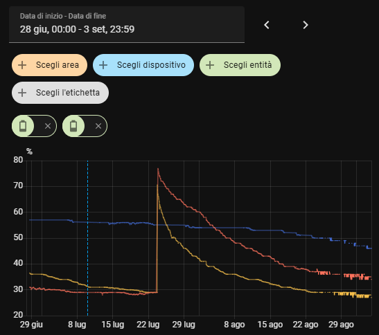

I use a couple of H5179 and a 5075 via esp32_ble_tracker “active” mode and battery is not that bad. And i’m using old rechargeable batteries.

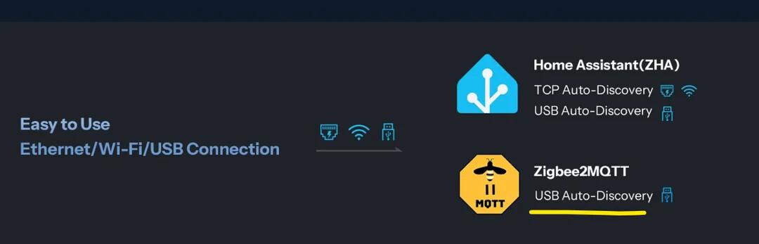

i saw the new Sonoff Dongle Max that seems promising for price/availability/performance. But i have a doubt.
On the official page for zigbee2mqtt it only says usb auto discovery. But can it be configured via tcp connection with zigbee2mqtt just like the smlight?
Using this configuration:
# Ethernet adapters - use format "port: tcp://192.168.1.12:6638" <<<======
Yes it can.
