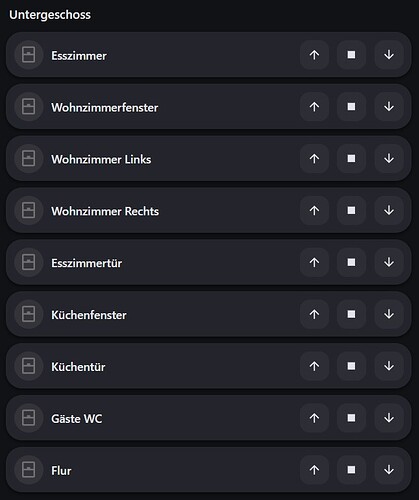

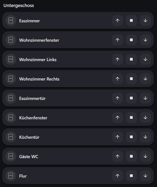

  • Central control of all shutters

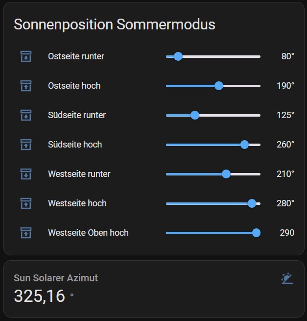

2. Sun‑angle shading
  • Triggered by azimuth (sun angle)
  • A toggle on the dashboard enables “summer mode”
  • Adjustable thresholds per facade
  • Shutters move to “slit” position at certain sun angles, and go up again when angle changes

  • Dashboard: manual control of all shutters; long‑press sets them to “slit”

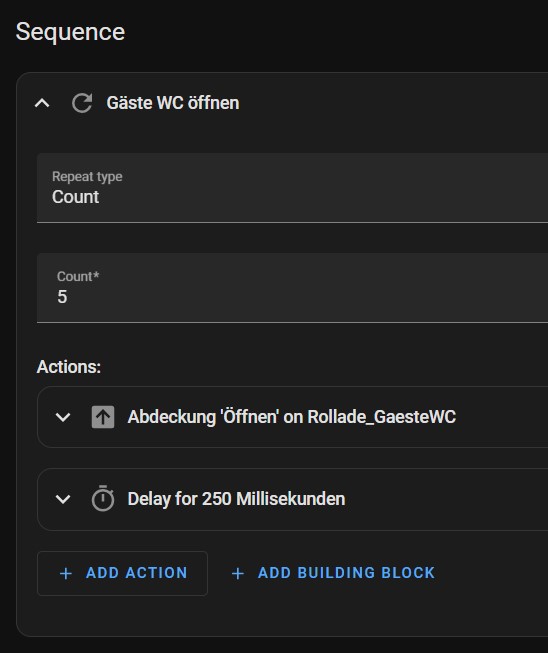

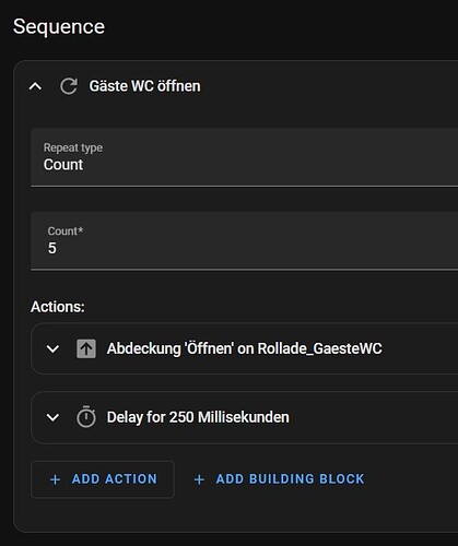

:hammer_and_wrench: Issue: Shutters occasionally didn’t respond
This was due to the number of radio commands sent.
Tip: Cherubini remotes let you configure repeat count (e.g. 5 signals) — I matched that in RFXcom, and it’s now rock‑solid.

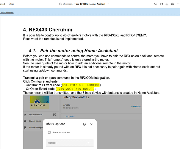

Cherubini is not supported by the RFXCOM integration. See the “Use RFXCOM in Home Assistant” pdf available on the Downloads page.
This pdf describes how to use the RFXCOM integration to control Cherubini.
Better option is to use MQTT. See the RFX MQTT User Guide.pdf how to add the Cherubini.

The ‘Use RFXCOM in Home Assistant Manual’ covers the Cherubini
