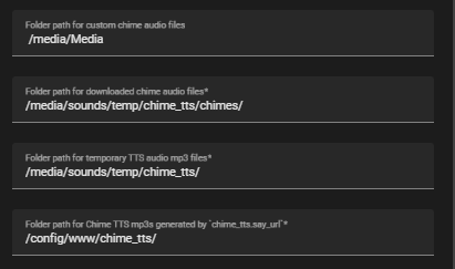

Path shown in config:
This path works fine to play files, but will not enumerate the pick list.
Full logs:
