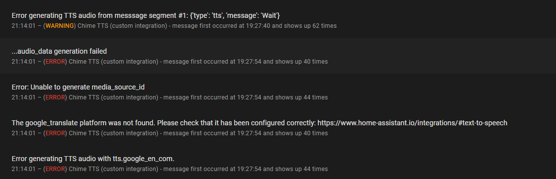

I’m not able to use chime.tts with a Logitech Squeezebox. tts.speak works.
There are several errors in the log:
The google translate platform is configured correctly and works (tts.speak for example).
Anyone has chime.tts in use with a Squeezebox?

Hi @Eisbaer2. Based on the console logs you provided I think the issue is with the TTS integration you are trying to use, and not necessaril the Squeezebox.
When Chime TTS initializes, it looks for all TTS platforms added to your Home Assistant instance. They should be available as drop-down options in the TTS Platform field when using the chime_tts.say / chime_tts.say_url services.
It might be helpful to review the full debug logs to get an idea of what’s going wrong. Can you please do the following?
  1. Enable debug logging
  2. Restart your Home Assistant
  3. Call either the chime_tts.say / chime_tts.say_url service
  4. Provide me with the full debug logs
Thank you. How can I send you the log file?
You can paste it in a reply in the thread, using the forum’s preformatted text button: </>
The created log has >1000 lines…
You can use pastebin
I’ve sent you the log via pastebin
Thanks for the logs. Unfortunately there wasn’t anything informative there beyond the errors that the integration couldn’t find the Google Translate TTS platform.
Can you please copy the full entity ID for your Google Translate TTS platform and paste it as the tts_platform value (eg: tts.google_translate_en_com)?
