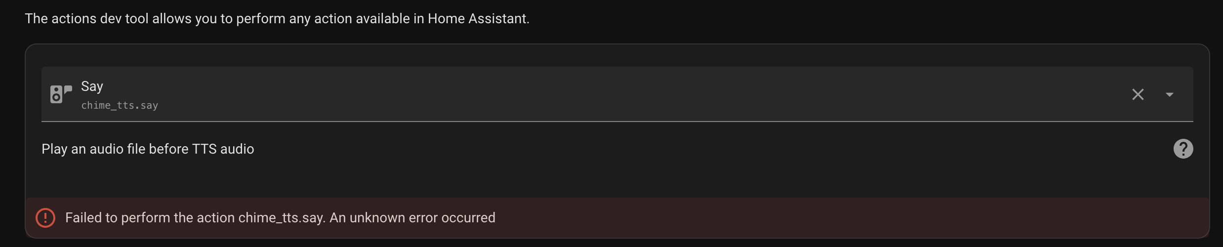

I enabled debug logging and entered the config within the integration settings, but it didn’t seem to generate any log files.
If I try to call chime_tts.say from Actions under Developer Tools, I’m missing all the fields that used to exist.
These are the only logs I can seem to find for chime_tts:
Unable to parse services.yaml for the chime_tts integration: expected str for dictionary value @ data['say'|'fields'['chime_path']['selector'['options'][26]['value']
August 6, 2025 at 3:22:23 PM - (WARNING) helpers/service.py - message first occurred at August 6, 2025 at 3:22:23 PM and shows up 2 times
/usr/local/lib/python3.13/site-packages/pydub/utils.py:300: SyntaxWarning: invalid escape sequence '\(' m = re.match('([su]([0-9]{1,2})p?) \(([0-9]{1,2}) bit\)$', token)
August 6, 2025 at 3:15:38 PM - (WARNING) Chime TTS (custom integration) - message first occurred at August 6, 2025 at 3:15:38 PM and shows up 4 times
Anything else I can try? Thanks again.
With the latest version of HA, there are no options to select when creating a new automation. Existing automations are working fine but can only be edited in YAML
It looks like your chime_tts/services.yaml file may have been corrupted.
Can you please try the following?
  1. Uninstall Chime TTS
  2. Reinstall Chime TTS
  3. Restart Home Assistant
I uninstalled Chime TTS via HACS, reinstalled, and restarted HA. I am still seeing the same log issue related to the services.yaml, and the configuration options within automations or Developer Tools for chime_tts.say still doesn’t display.
It seems like the removal of Chime TTS didn’t alter the underlying integration config (all my previous settings persisted), so perhaps something more nuclear is required? But I am not the only person reporting the issue with 2025.08 and not having the ability to configure existing automations outside of YAML.
Edited: I tried again, this time deleting the integration before removing from HACS. I confirmed that all configuration files were removed. Reinstalled and reconfigured. The same log error related to services.yaml shows up again. I even tried manually editing services.yaml to remove references to id027, or replacing null with a path, but it appears that the file gets auto-generated.

I have uninstalled and reinstalled with no luck. still no UI. All of my automations work fine, I just have to do new ones in yaml mode.
Every time I start HA, I get the following warning in the log:
ogger: homeassistant.helpers.service
Source: helpers/service.py:510
First occurred: August 21, 2025 at 4:50:46 PM (1 occurrence)
Last logged: August 21, 2025 at 4:50:46 PM
Unable to parse services.yaml for the chime_tts integration: expected str for dictionary value @ data[‘say’][‘fields’][‘chime_path’][‘selector’][‘options’][26][‘value’]
I’m seeing the same thing. I removed and reinstalled Chime TTS but the issue persists
Exactly the same problem here - all automation still works just annoying to see the errors in the log. Hope there will be a solution soon!
same problem here…
I also installed it on a new HA server but the UI is not there.
Man, I thought I was going mad.
I’m a first time Chime user and after installing I’ve been tearing my hair out trying to figure out why there was no UI in Developer Tools > Actions chime_tts.say.
Clearly something else going on here.
It looks like a fix is in progress on github, so hopefully we will see a new version drop soon. Appreciate the dev and those users who helped track down and correct the issue.
