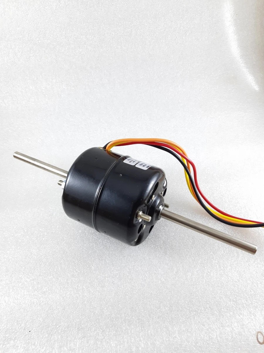

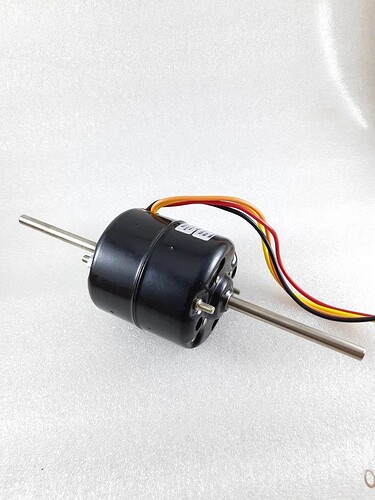

Generally cheap fans use a brushed motor. Something like this even has 3 speeds.
https://www.ebay.com/itm/254474344158

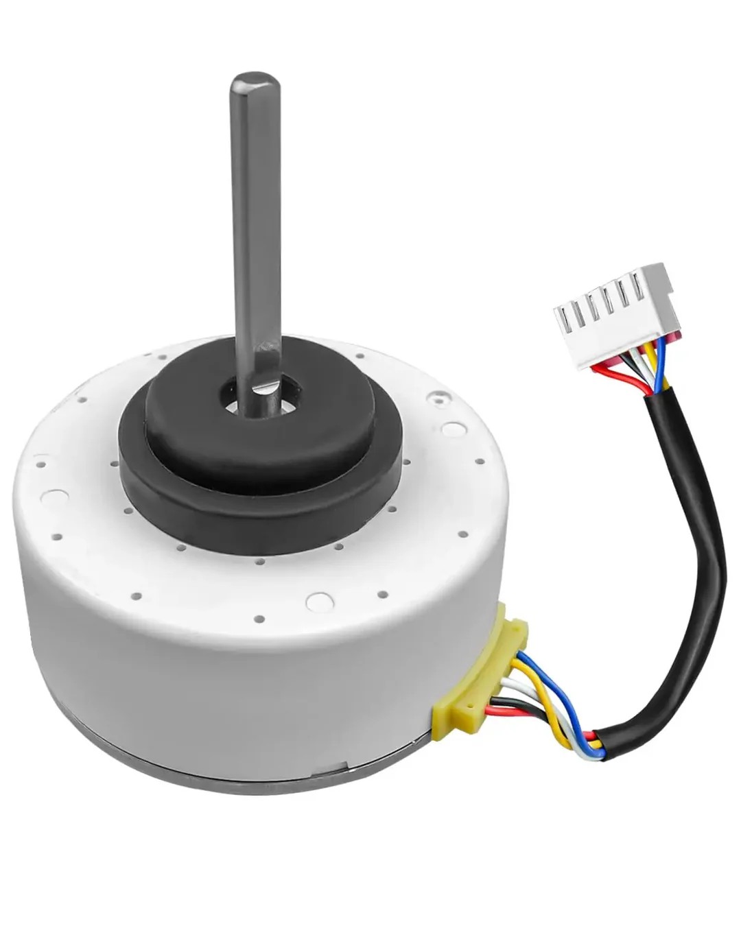

There are also brushless motors which offer more control and can be more efficient.
Something like this
You need to find a motor that has the diameter, length, and shape necessary to fit your existing fan.
If you get a simple multi-speed motor, control is probably much easier.
