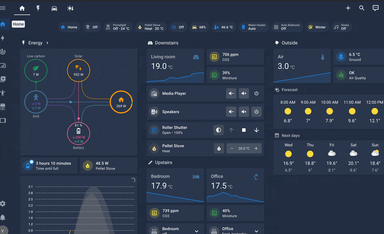

For a few months now, I’ve had an issue where Lovelace gets extremely slow/choppy for a few seconds after switching from another tab. It can last up to 10/20 seconds.
This is only noticeable on PC (Apple Silicon + Firefox, Linux + Firefox). I haven’t noticed it on the native iOS HA app.
It only happens after a long time without viewing the tab.
During the choppy sequence, the dashboard data is not refreshed. Button presses (changing dashboard, …) are not registered, or very late.
After the time period, HA seems to “catch up” and the data refreshes multiple times in the span of 1-2 seconds. Then everything works fine.
However, if I lose patience and force reload the page, it works immediately.

An example after not visiting the tab for maybe 10 minutes. The chop seems to be proportionate to the inactivity time, so here it only lasts for about 5 seconds:
Screen Recording 2026-04-15 at 08.32.27
