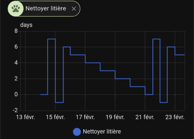

I am using this tool for a couple of weeks now and I noticed a behaviour with all my tasks that I do not understand:
  • I’ve setup three weekly tasks, all three behave the same,
  • Let’s say I setup the task “clean litter” every saturday. It shows up well in the calendar, and I used your guide to show the Today tasks and Overdue in a dashboard. Works like a charm and If I don’t complete the task on saturday, it moves from today to overdue on sunday midnight sharp. Perfect.
  • It’s Saturday, I complete the task. I trigger an automation (button on the dashboard) and we can see the sensor goes from 0 (due today) to 7 (due next week). But at midnight, it goes back to -1 (overdue) instead of 6. If I mark the task complete again, then it goes to 6 and the sensor behave as expected until the next due date…
It is kinda annoying, am I missing something ?
