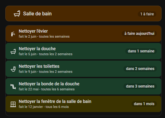

Hi guys,
I've been using HA for a few years, and now starting to get into more complex coding projects. I'm currently working on a chore tracker, and I'd be grateful for any feedback or tips you can give me.
(I have looked at add ons and HACS but nothing quite fit what I wanted, hence making it from scratch. This is loosely based on the Sweepy app, which I had previously been using but I want my own offline/free/tailored-to-me solution)
My issue: Currently card 2 is acting as one giant button, hence the workaround with browser_mod.
  • It works fine but it's a bit clunky
  • The browser_mod chores aren't dynamic and so aren't in the same order as they appear on card 2.
  • It also means I have to manually update the tap_action and the hold_action menus every time I add/remove a chore
  • I'm also thinking further down the line I would like to have card 1 in each room on my main dashboard, and clicking it would bring up card 2, so the less sequential popups the better.
I would like card 2 to be a dynamic list in due order (as it is currently) but each chore is its own button, where tap_action automatically updates the right input.datetime for that chore and hold_action automatically brings up the right input.datetime to edit the date. Would be really grateful for your thoughts on how to achieve that!
Also (minor detail though) if anyone can suggest how to remove the space between the last chore and the bottom of the card containing the chore list that would be fab.
Thanks!
Current setup (in a separate chore dashboard):
  • each room looks something like this. It's a vertical stack with card 1 [overview of the room cleanliness] and card 2 [all the chores specific to that room].
  • Card 1 changes colour depending on the state of chores in the room (due/overdue/ok/due soon), and says how many chores are due/overdue.
  • Card 2 is a dynamic list of all the chores in the room, ranked in due order. Colours change based on state (due/overdue/ok/due soon), and it says when it's next due / how long it's been overdue, and says when it was last done and how often it needs to be done.
  • a short press on Card 2 uses browser_mod to bring up the list of chores that I can click individually to say it's been done today
  • a long press on Card 2 uses browser_mod to bring up the chores' input.datetimes to manually adjust the date they were last done
