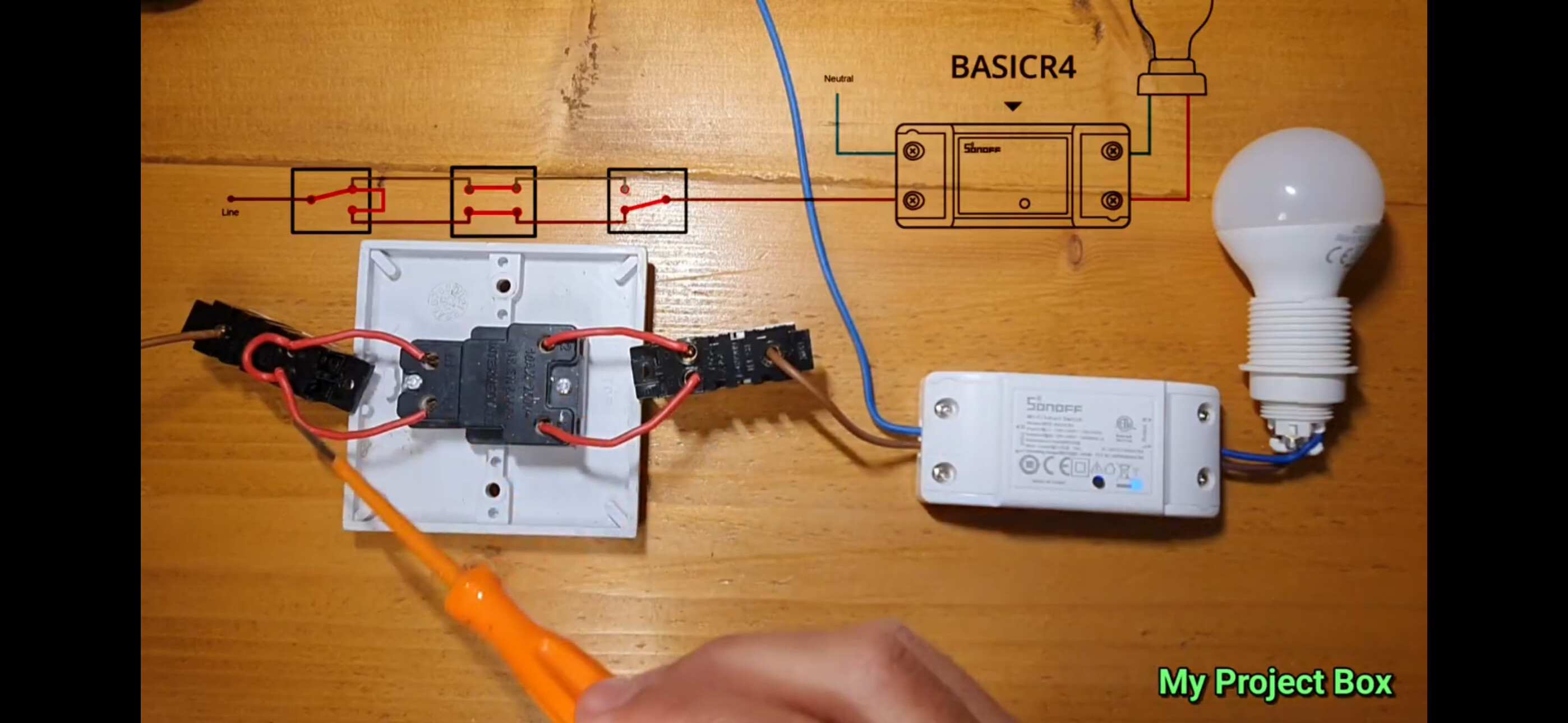

If you can access your light fixtures, you can just install relay like sonoff basic r4/v5 up there with minor wiring job

Installing like this means that when any light switch is switched off on that also turns off the live to the Shelly.
If you install custom firmware on the basic r4 like tasmota or esphome, you can detach the relay.
Instead of cutting the power, it just sends on/off trigger to HA and you can use that as automation to toggle the dimmer.
