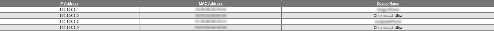

I have a newly installed HASS on Rasberry PI 3 Model B.
I have 2 chromcast devices. One of them is working fine but the other is not operable.
From ConfigurationIntegrationsGoogle Cast, I see
And the log:
Fri Nov 23 2018 13:05:37 GMT-0800 (Pacific Standard Time)
Error doing job: Task exception was never retrieved
File “/usr/local/lib/python3.6/site-packages/homeassistant/helpers/entity_platform.py”, line 339, in _async_add_entity
‘Invalid entity id: {}’.format(entity.entity_id))
homeassistant.exceptions.HomeAssistantError: Invalid entity id: media_player.
I searched for this problem - they all said it’s because of the non-latin characters. But in my case, I’m sure there’s no non-latin characters. Any ideas? What’s the best way to debug this?

Is the IP address correct for the second cast device?
It may have changed if you have not reserved an IP address for it in DHCP in your router.
Can you cast to it with other devices (your phone for example).
Also is the second cast device on?? Mine is always unavailable because it’s powered by a USB port on my TV and it isn’t available unless the TV is on…
I’m sure the IP address is correct, and I’m casting from my iPhone while I’m experimenting this…
