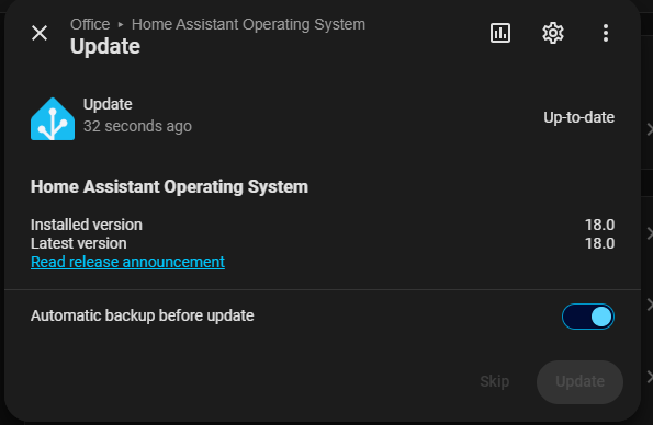

Since I use the "Advanced SSH & Web Terminal" addon/app I went with the third option, so:
Updated HA normally to 18.0
then I SSH into the pi using the user/password defined on the addon/app configuration
Issued command "ha os boards raspberrypi firmware update"
waited for it to update the bootloader to "2026-05-11"
Issued command "ha host reboot"
waited for reboot, and its done.

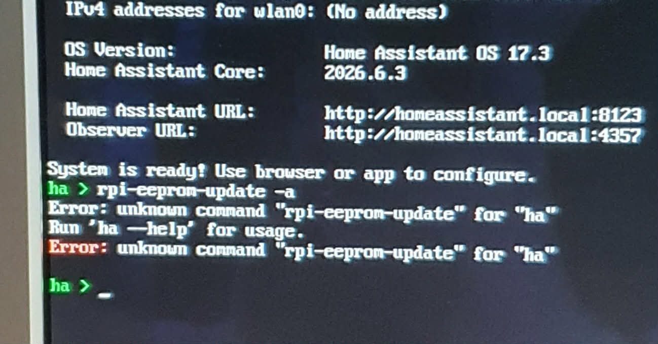

OK, I've connected a keyboard and monitor to the HA server.
I've entered rpi-eeprom-update -a and i get:
You skipped the login step:
From my original link:

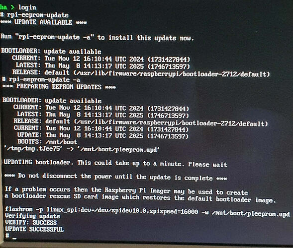

There you type login, then enter. Then you will reach the root shell prompt #
Just updated, no keyboard or display needed. My pi5 was on very old firmware. Upgrade the OS to 18.0 which loads the firmware files and updater so they are available. Then in terminal from a HA session just enter the "ha os boards respberrypi firmware update" command. It will tell you to reboot after and alll set!
Ah! from the hash ting!
So, now I'll do the HAOS Core update....

I just ran this update by the second method. OS updated first, then connected in via terminal in HA to update the firmware. Seems a bit backwards but worked fine.
