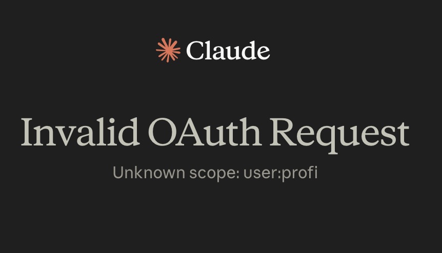

I get this when I try to authorize. I did copy the whole 2 lines. I didn't have a problem with the original fork of this add on. I just moved to this one because you are updating it and he was not. Looking froward to using it with Opus 4.8.
Thanks for doing this. :+1:t2:
