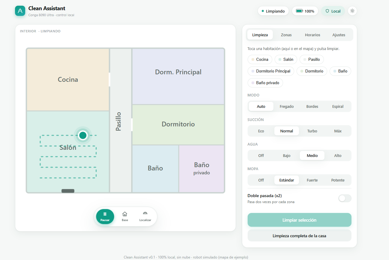

What it does
  • :world_map: Live map (rooms + robot position) with zoom/pan and touch support
  • :broom: Start / pause / dock / locate, per-room cleaning, suction/water/mop, cleaning modes,
    dustbin auto-empty frequency, consumables tracking
  • :door: Room names, room type & floor type, merge/split rooms, m² per room
  • :prohibited: No-go / no-mop / double-pass zones drawn on the map
  • :alarm_clock: Visual schedules (per room), synced with the robot, firing at the correct time
  • :house: Multiple house maps: create / switch / rename / delete (fixes the “duplicate maps” mess)
  • :bar_chart: Cleaning history — also fed by the robot’s own uploaded reports, still no cloud
  • :locked_with_key: Backup/restore of your config and the robot’s identity (“recovery key”)
  • :mobile_phone: Home Assistant MQTT entities via auto-discovery (vacuum, battery, per-room buttons,
    power/water/mop selectors, schedules, low-water sensor…)
