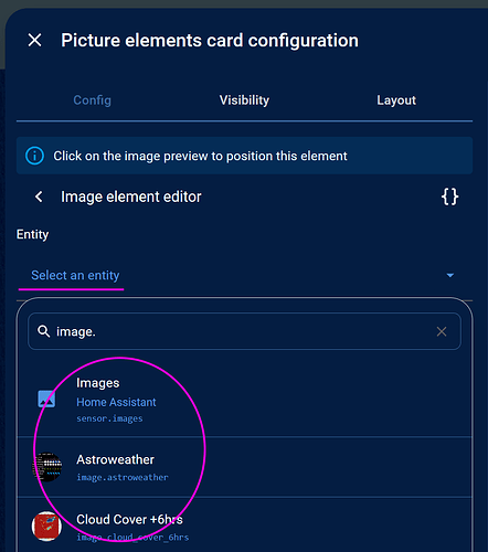

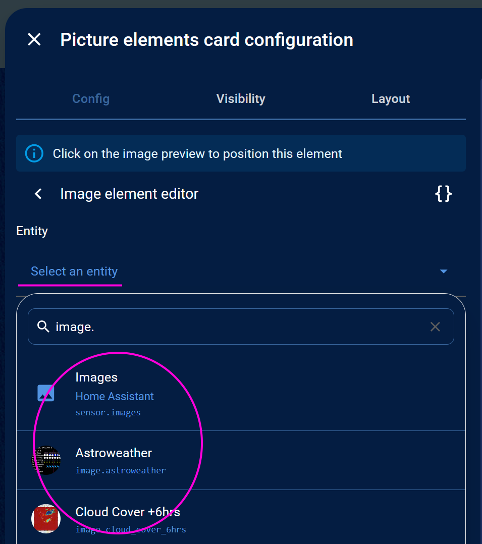

There are other suggestions to use an image entity on the card which would accept a template argument but placing an image on the card in that manner is unsatisfactory. The placement becomes problematic and the presentation is not what I am after.
Most core frontend cards do not accept templates.
If you need a dynamic image then create a template image and display that in your picture-entity card. You can add the image entity for an image element.
