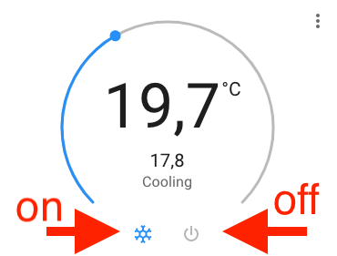

Your log says: Mode: OFF and Action: OFF, so it looks like the controller on the HA dashboard is deactivated (OFF button pushed). What happens if you click on the fan icon (ON) in the HA dashboard?
thermostat in HA
