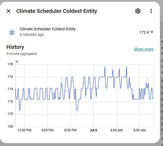

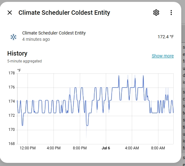

Thank you for a truly great integration with so many features. I installed it and it's working well. I have one very small niggle - the sensors climate_scheduler_coldest_entity and warmest have some weird values - I suspect caused by the fact that I'm in the US and using Fahrenheit :frowning:
The actual temperature should be around 79 F, so what I think is happening is the 79F is being unnecessarily converted to Celsius which gives the 170+ readings.
I live in Phoenix, Arizona but 172 F would be hot even for here :slight_smile:
Also the sensors climate_scheduler...rate are in C/hr rather than F/hr .
