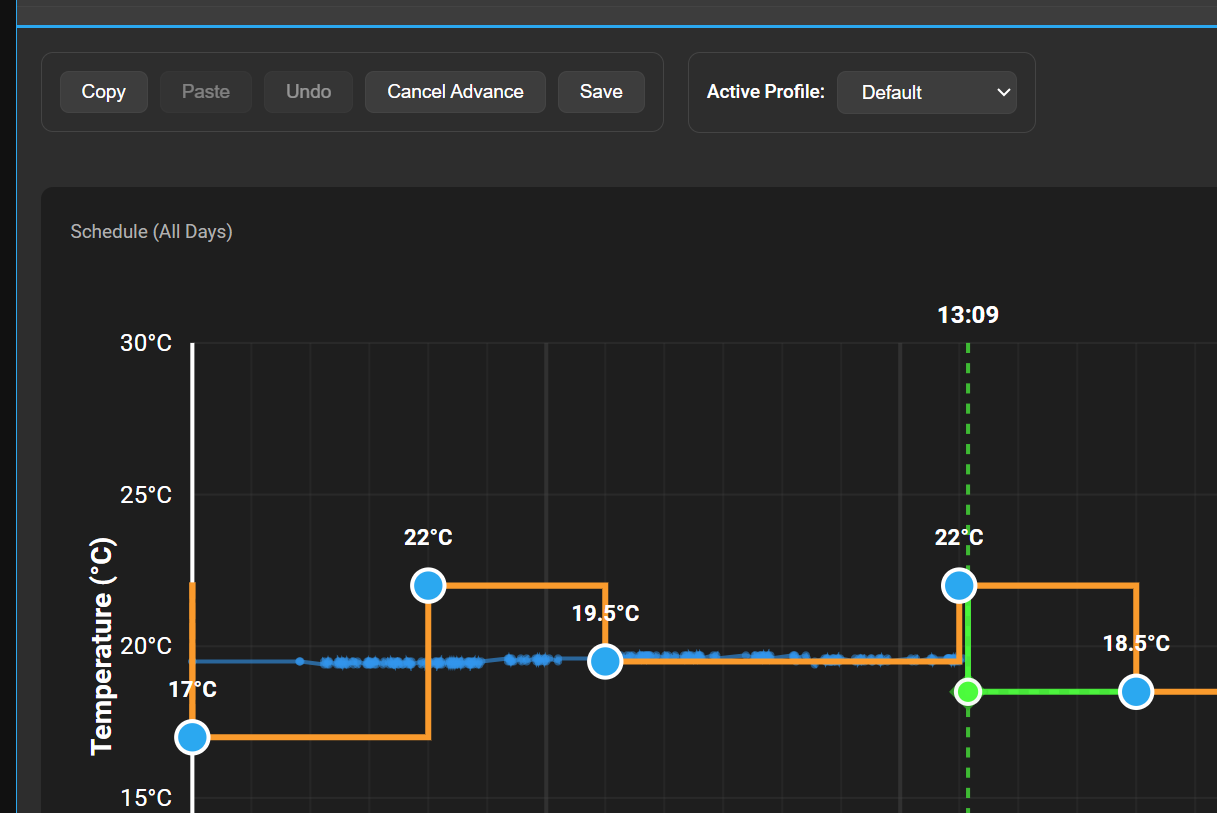

  • With the two profiles defined above, I can select for example Home profile for Monday in the Active Profile selector. then the climate scheduler immediately displays the profile of the current day (in my case Sunday whereas I would like to keep seeing Monday).
  • I want to schedule for Monday: a) I click on Monday (Mon box in blue) , b) I select Office c) Save d) the climate scheduler displays Sun (Sun box in blue) e) The heater switches On (Why ? - No reason for that - the temperature is above the target)
  • What does exactly the selector ‘Active profile’ show ? (unclear for me). If today is Sunday. I understand that I can switch between the two profiles for the current day. Does it display the profile of the current day ? or the profile of the day I’m scheduling. If I select Monday, the Office profile is well displayed but the Active profile selector still displays Home which is the profile of today. I would have expected that the Active profile selector displays the one choosen for the day I’m working on and not the profile of the current day (In this case, the Office profile saved for Monday).

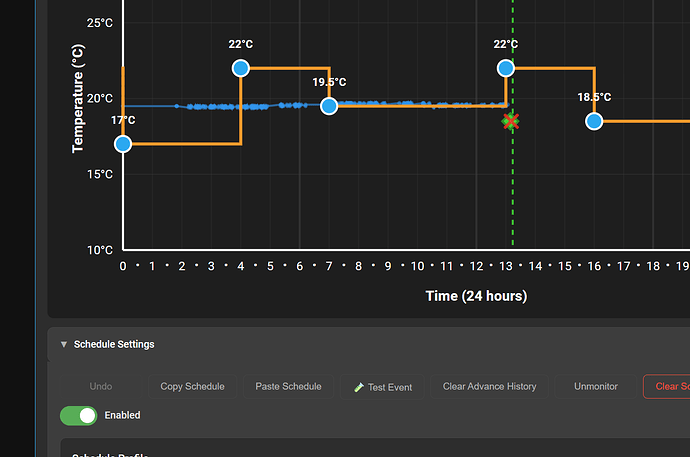

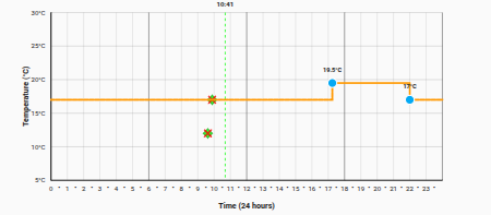

Two small green boxes with red cross around 10:00 can be seen on the profile. What does it mean ? How to delete them ?

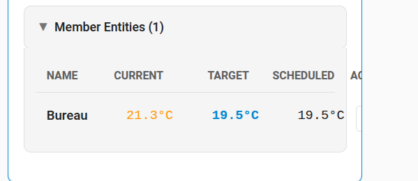

There are display errors.
What should be displayed on the right, starting with AC ?

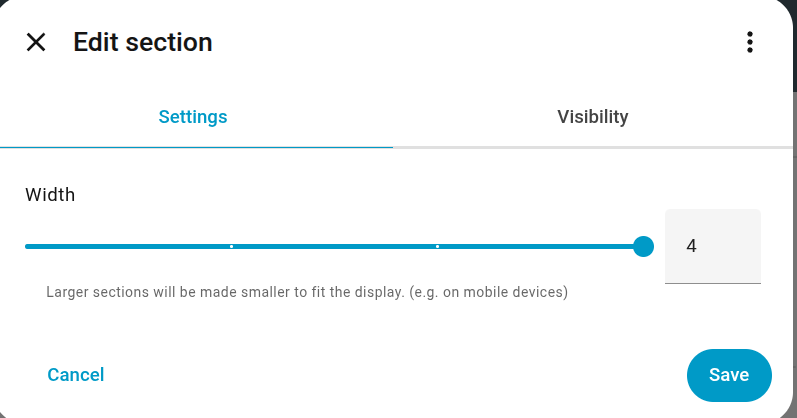

The title and the value are not aligned : Current is in the middle or left of the box, whereas the value 21,3°C is on the right, both in the middle would be niceier.
The widht of the screen is set to 4
The tile does not benefit from it:

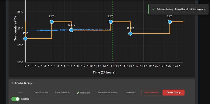

Schedule Advance
The green boxes show times when the schedule advance feature was activated, this instantly applies the next node in the schedule. For example, if you get home early you can activate this to warm up the house. It will show a green dot at the time you clicked advance and a green line to the next node, this shows it’s a temporary adjustment. If you then click “Cancel Advance” it goes back to the original schedule and leaves a red cross behind at the time you cancelled. I thought this useful so that you can see when people wanted the schedule to change and maybe adjust it.
“Advance” is used to mean “use the next” so I may need a term that translates better. :slight_smile:
Under Settings on the schedule there is a “Clear Advance History” button, if you click this those icons should be cleared.

UI Issues
Regarding the UI, it’s a mess at the minute and something I’m concentrating on for the next phase of development. I only made this work as a full size panel, if you use “Panel (Single Card)” the layout should be better at least.
Profiles
A profile is currently for the entire schedule so for individual days and weekday/weekend it applies the same to all periods, I hadn’t considered that people would want different profiles per day/period but I can add this in. I work from home so I’m always here and have a daily schedule with no profiles, I don’t hit a lot of these issues as a result.
When you change profile it currently refreshes the UI and defaults to showing the current day, I can understand why this is frustrating for sure! I’ll add it to the list to improve.

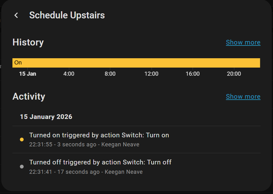

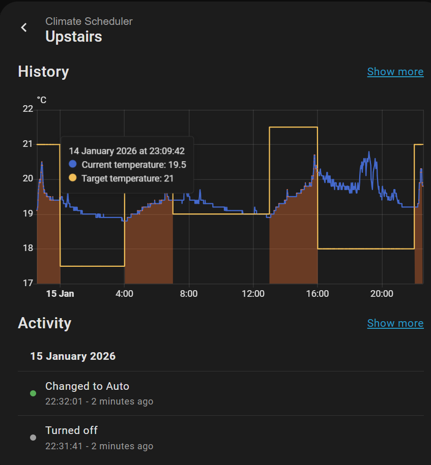

ClimateScheduler works really well for me. However, all my schedules (to be precise: the scheduler groups) keep getting deactivated somehow. I woke up on three consecutive days now to cold radiators - activated the groups, and everything works just fine. I can’t think of any of my automations that would do that. Does that happen when I edit schedules? Is there something in the documentation that I missed? Or ideas anyone how I could troubleshoot?
I had accidentally created a cyclic dependency in my automations involving Climate Scheduler: action setting schedule profiles + action triggered on schedule profile change. When I broke the cycle by adding additional conditions, the behavior was gone.
But then when I tried to build something similar to confirm, I could not reproduce anymore. :frowning: So I really don’t know… problem is gone, but I’m not sure why.
Oh crap, there was a bug I thought I squashed where it will recreate entities with climate_scheduler_ in front of them for some reason. I had some that had recursed about a dozen times, I’m guessing as I so frequently updated…
“All Zones” isn’t a valid group, but I could look at adding something similar if it’d be helpful?
That’s a really odd one, I’ve not heard or seen that behaviour to be honest. If you look in Settings → Entities and search for “Schedule ” though you should be able to bring up the history, there are also virtual climate entities that represent your schedules too.
You could at least check what time it’s happening as if it’s always the same time it could narrow it down.
Thank you. I did look at the entities for the schedules, and I could also actually watch the schedule groups being deactivated live when I triggered these automations for the profiles by hand. As I wrote above, problem is solved now, but I don’t know exactly why, and I can unfortunately not reproduce.
