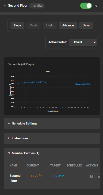

Hi, newer to Home Assistant, not afraid to dive deep but I’m trying to use your scheduler, looks to be exactly what I want so thank you very much for all this work, but would like to see temperature sensors in that area along with the thermostats. I have a Z-Wave thermostats but those only show up on the graph none of the temperature sensors graph along with the temperature reported by the thermostat. What do I need to do to get the temperature sensors (have three switchbot BLE [SwitchBot Indoor/Outdoor Thermo-Hygrometer | IP65 Waterproof | SwitchBot US] thermo-hygrometers) graphing too? Seems like some of the example screenshots it should just pick it up automatically. Thanks in advance!
When you see multiple data graphs its from having multiple climate entities (thermostats) in the same schedule, there’s no way to add just a temperature sensor right now. I’ve added it to the backlog.

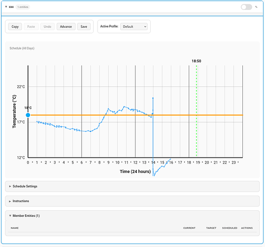

first of all, thanks for that wonderful integration!
I am new to HA and was looking for a simple time schedule for my climate controls.
I am using Homematic IP TRV’s with Sonoff Temp sensors, both combined via Better Thermostat.
With Climate Scheduler on top it was possible to assign individual temp profiles for each room (aka group) and via profile switch, it was possible to realise vacancy and party modes.
This works excellent in 3 of 4 rooms.
In the last room I had experimented with a different TRV (TPlink) and then tried to switch back to Homematic IP TRV.
Doing that I tried to delete a group to redefine, but that didnt work.
I was only able to rename and disable the group.
Then I made new group, assigned a Better Thermostat entity, but that did not work. I tried to delete it, but no luck.
Even in 1 group, it tells ‘1 entity’, but no one is listed.
Obviously, I had produced some data garbage.
I had tried the buttons in the bottom of the settings section ('Cleanup Orphaned Entities etc.), they didn’t do anything.
Is it possible to edit some yaml files to cleanup my installation, or what can I do?
Thank you!
Can you create a group with a new unique name? It could be an easy win? Otherwise if you arent fussed about losing data you could use the factory reset option in the settings panel.

Hi Keegan,
thank you for your advice.
This morning, after a fresh reboot of HA and browser refresh, I was able to add a new group (unique names seem to be crucial - now I have prefixed my names: ‘csg_’ for Climate Scheduler groups, ‘bt_’ for Better Thermostat climate entities and so on).
And even better: I was able to delete the deactivated groups and now I could get rid of 8 orphaned entities.
Thanks again.
Now all is working as expected - great job!
